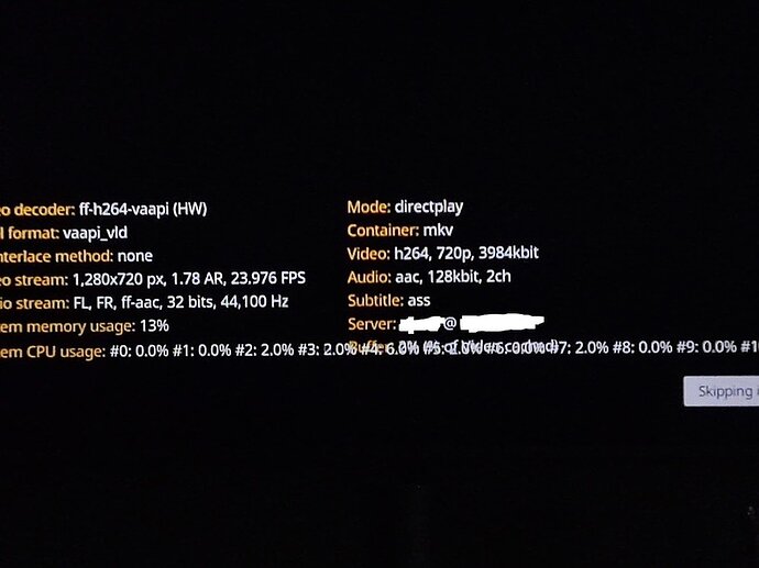

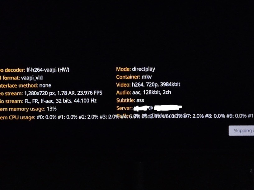

I seem to have come across 2 bugs.
The first is a small one related to the stream info display when playing a video, if the video has subtitles the buffer line of the stream info gets covered by the cpu usage. Shown Below.

Was able to reproduce. This only seems to happen when you pause before backing out of the video. I’ll investigate, thanks. No, it’s a timing edge case. This only happens when we seek on start (with resume or early auto skip intro), in certain situations (playback started, seekDialog not initializied, we’re talking <1ms edge case that happens depending on Kodi device performance).
All fixed in 0.7.5-prerelease9: script.plexmod.zip (3.5 MB)
Please re-test, thank you!
