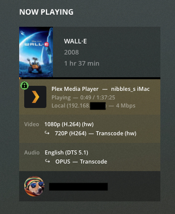

The NAS compatibility list shows that the TS-451+ can hardware decode 8bit HEVC at 4K resolution, but when I test that, it doesn’t hardware decode any HEVC Jellyfish at all.
I tested by transcoding 1080p HEVC videos on the fly to a lower resolution and bitrate. It worked fine for the h264 Jellyfish. I also tested with a combination of TV Shows, Films, and KODI demos.
H264-H264 transcodes work great, hw decode => hw encode, full pipeline.

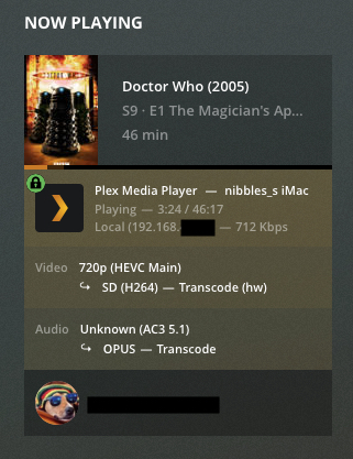

HEVC-H264 transcodes do not, sw decode => hw encode

The fault is mine. I will take the hit for this one.
The J1900 will not support HEVC but will support H.264
