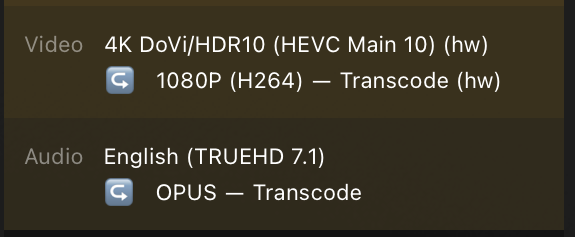

Tested 1.32.5.7349, seeing this on my Xeon(R) W-1350P:
Sep 15, 2023 23:47:52.565 [140717916982072] INFO - [Req#62c/Transcode/vrpm3ibplrlohm4ray7hulpl] Preparing driver icr for GPU RocketLake-S GT1 [UHD Graphics P750]
Sep 15, 2023 23:47:52.568 [140717916982072] INFO - [Req#62c/Transcode/vrpm3ibplrlohm4ray7hulpl] Preparing driver imd for GPU RocketLake-S GT1 [UHD Graphics P750]
Sep 15, 2023 23:47:52.809 [140717921200952] ERROR - [Req#673/Transcode/vrpm3ibplrlohm4ray7hulpl/bd6540d8-0ed8-4f54-a278-560446b7aad9] [AVHWDeviceContext @ 0x7f2d742ee040] No matching devices found.
Yet it still does say Transcode (hw) from 4k HDR down to 1080P SDR. Can confirm with intel_gpu_top. Same on 1.31.3.6868 FWIW.
@infernix
I need more than 3 lines to go on.

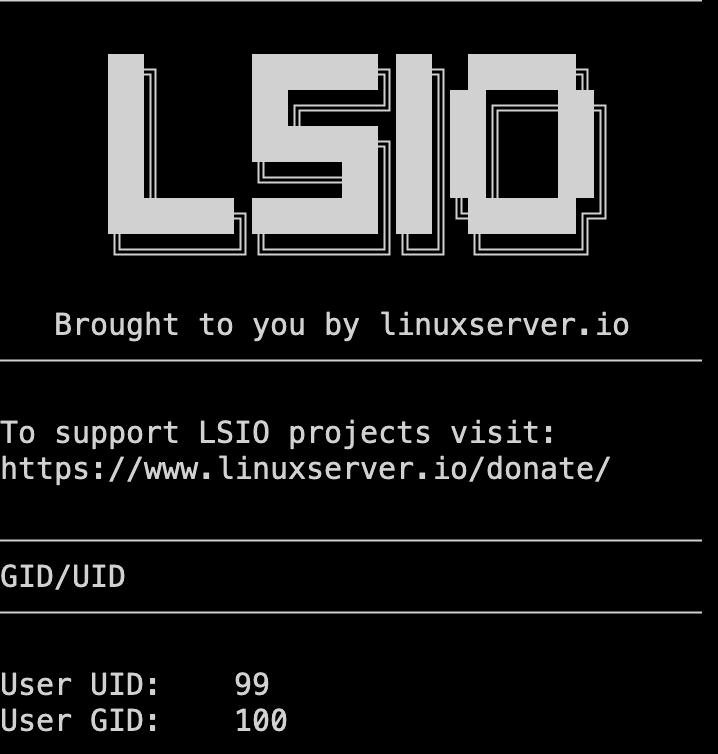

I updated on Unraid the Linux Server version 1.32.5.7349-8f4248874 - latest (Docker) a couple hours ago and I was unable to access Plex at all! It got stuck on User UID: 99 and User GID: 100 and would not progress any further. In Unraid it appeared to be running but I was unable to connect to the plex.tv server at all. I thought I had corrupted preferences or a database corruption. I finally rolled back to 1.32.5.7349-8f4248874-ls181 from 11 days ago and my server is back up and running. I couldn’t pull any logs as the log I had is this screen shot. I hope this helps for digging a bit deeper.
Good luck with the fix!

Those are the same build unless LSIO is doing something in there.
Hi @ChuckPa , Yes, I thought the same. Here is the link to various builds. If you scroll down you will see the version (docker pull linuxserver/plex:1.32.5.7349-8f4248874-ls181) from 19 days ago. The one that was released a few hour’s ago is versioned 1.32.5.7349-8f4248874
https://hub.docker.com/layers/linuxserver/plex/1.32.5.7349-8f4248874-ls181/images/sha256-760d003bac029cca84beebe89d3a2eeeb42c018c4c9dbee765e2af429c78b886?context=explore

There was a regression in the LSIO scripts which turned a chown on only the base config folder into a recursive chown of the config folder, which includes the metadata folder, that takes a very long time, and thus blocks the startup.
It was introduced with Change lsiown to skip files owned by user · linuxserver/docker-mods@8adebf4 · GitHub & fixed just a few hours back with Fix lsiown edge cases by quietsy · Pull Request #763 · linuxserver/docker-mods · GitHub
