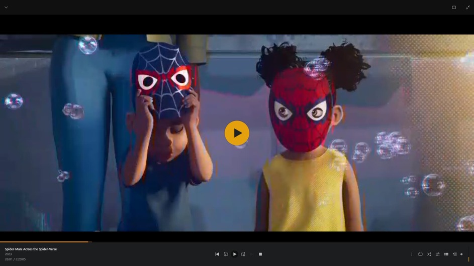

Here is from my GeminiLake
at 20 Mbps
at 2 Mbps
The loss in color and quality is expected when turning it down this far.

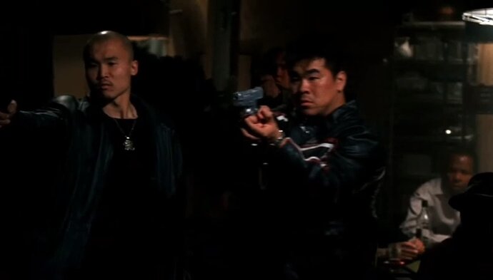

This is what I get in converting to 4 Mbps @ 1080p
Taking it down to 4 Mbps @ 720

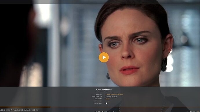

Here’s your file, loaded and playing at 720p 2 Mbps
Look at her eyes. They’ve been overly processed. The curvature is gone at the iris.
(unless that’s how she looks??)
In watching the whole clip, I get no color breakup or lines or anything.

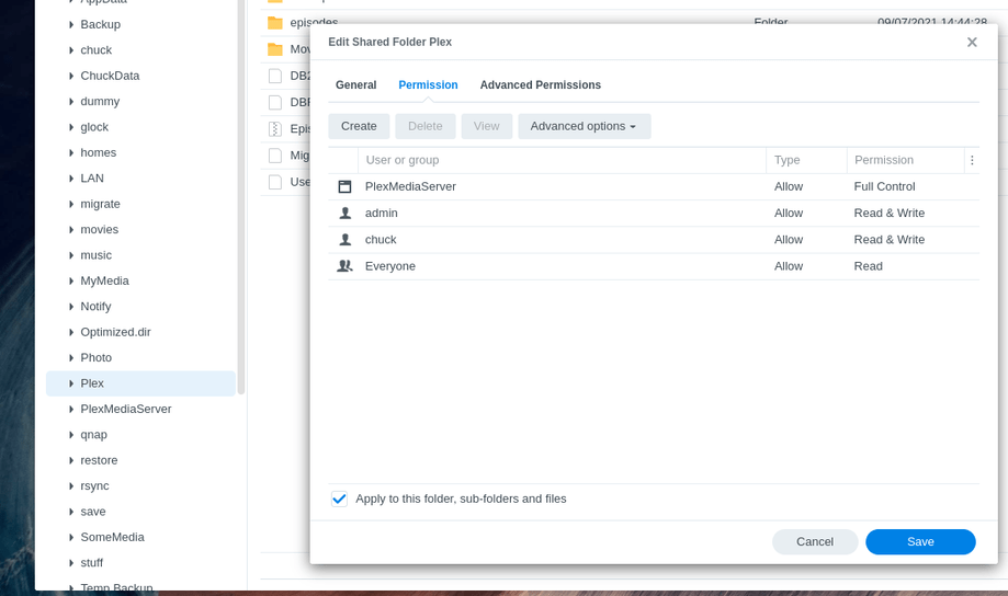

Here’s the first part of the instructions.
  1. Stop Plex (docker)
  2. If you don’t have a “Plex” shared folder , Create one
    – As you do, pay special attention to granting CUSTOM permissions to SYSTEM INTERNAL USER ‘Plex Media Server’
    – Full Control permissions == All ADMIN + All READ + All WRITE
  1. If you do have one, and it has “Library” in it. Let me know.. It is likely something old to be cleaned up / discarded (?)
  2. Presuming empty,
    – Open FileStation
    – Navigate to the Docker shared folder and into Plex
    – Right-click Library → Move to → “Plex” shared folder.
    (This will take time – Be patient and don’t interrupt it)
  3. If you have the DSM 7 Plex app installed, you can now Uninstall + ERASE it
    (we’re going to ‘migrate’ your docker Plex server into the DSM 7 native structure)
  4. When all is done, You’ll have Plex / Library / Application Support / Plex Media Server
  5. Last step is to apply Ownership again to all the files in the Plex shared folder.
Here’s the How-To (you’ve already done part of it)
  • Scenario 2
    – Start at Step 4
    – Don’t miss any
Let me know when you’re this point
I’ve gotten to the point of migrating files into the Plex shared folder and permissions should be correct now.
OK.
The PlexMediaServer shared folder is Empty ?
As Final Confirmation of permissions.
FileStation → Right-click on “Plex” → Properties
  1. See “Full Control” for “PlexMediaServer”
  2. Check the box: “Apply to this folder, subfolders, and files”
  3. SAVE
(this will take a moment but not too long)
When this is complete,
Download this,
Package Center
Manual install this PMS
It will sit at “Installing” while it runs.
  1. Don’t interrupt it or Refesh away
  2. In a new tab – open to the DSM Desktop
  3. after about 3 minutes, you’ll see a file “Migration.log” in the Plex shared folder
  4. This is the progress log
  5. When Cleaning: Completed" it’s all done
