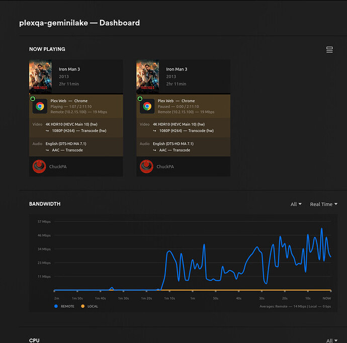

ALL:
Update on our progress
Please forgive me not testing better yesterday
Gemini Lake HW transcoding - (HDR tone mapping OFF) works.
I am playing HDR content in Plex/web and, maybe it’s the video, but saturation looks very good
4K HDR hardware transcoding now working with 1.32.6.7515. Tested with HEVC and AV1 files.
