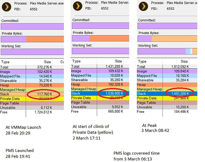

Thank you very much for getting all the diagnostics. The process is close to the 2Gb maximum and evidence suggests it did hit 2Gb at the peak times shown
This is now being investigated using the excellent data that you provided in terms of the 81 log files and the VMMap saved data

Have been looking at the VMMap data and logs and discussing with the development team.
The memory is being used up threads that are being created but do not appear to be doing anything - nothing in the logs for 1110 threads of the 1165 threads that show up in VMMAP at the peak at 08:42:19. With each thread taking up minimum of 1.25 MB memory that used up about 1.5GB. There should not be that many threads created and it is not clear as to why that is happening.
The server I believe was running for 44 hours when the steep climb started at 17:11 2nd March and peaked after 59 hours of running at 08:42:19 3rd March.

The issue is the amount of memory used up for the stack (for Plex Media Server threads) - it should not be climbing to the level it has got to) . The following shows 3 snapshots which shows the stack totals at 3 different times. It is not clear yet as to why this is happening and why it is happening on your system but not other users. Previous users with the errors this gives rise to found that BitDefender was a factor. Why that was I do not know. I am not sure if Trend Micro Maximum Security` would cause similar issues.
It could be some exception path that is resulting in new threads not being terminated.

Going back to the memory issue which appears to be due to extra threads being created within the Plex Media Server process adding 25Mb memory use for the stacks every hour, I have been discussing it with the development team and would like to go through this plan of action
You can continue to have Plex Media Server.exe monitored with auto-refresh by VMMap
If the problem does not go away and VMMap still shows the stack total memory figure for the process getting very high - it should never reach 1Gb for example, then do the following
  1. Save VMMap data into mmp file
  2. Capture the Plex Media Server logs
  3. Take a process dump of Plex Media Server.exe process. We need to use the 32-bit windows task manager to do that. Launch C:\Windows\System32\Taskmgr.exe and select the Plex Media Server.exe process and right click and select Create Dump
  4. Upload vmmap, logs zip, and zipped dump to dropbox and send me link by PM
May at some point need to use Process Monitor to establish what is creating these threads
