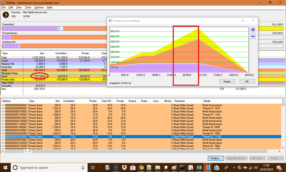

To investigate memory leaks, need to use tools as was used in these investigations
using tools SysInternals VMMap and SysInternals ProcMon with VMMap running after PMS is launched and and ProcMon to be run for 5 to 10 minutes during a time when VMMap is showing stead climb in memory use and reached over 1Gb

Thanks - it is the stack memory use as showing in VMMap that is going up - which as was seen in the D3D9.dll case before is due to threads being created - each occupying 64 Mb
need to now bring in ProcMon.exe - during a period of the commite dmemory climbing as can be seen here - would like to have a PML procmon capture for 5 to 10 minutes - to go with a VMMap mmp snapshot and logs for the period

Spent a number of days looking into the PML and VMMAP captures and logs. Nothing conclusive - have not been able to get all the PMS stack frames out of procmon.
The snapshots taken showed what looks like a threads leak
Snapshots
At 01:25:10 = 604 Threads
At 11:43:50 = 615 Threads
At 14:02:09 = 761 Threads (significant increase - in 138 minutes +146 threads)
Would need PML capture from procmon for period when the number of threads ramps up like this - to go with vmmap capture and logs. May also be of benefit to increase log files to 100 using LogNumFiles
