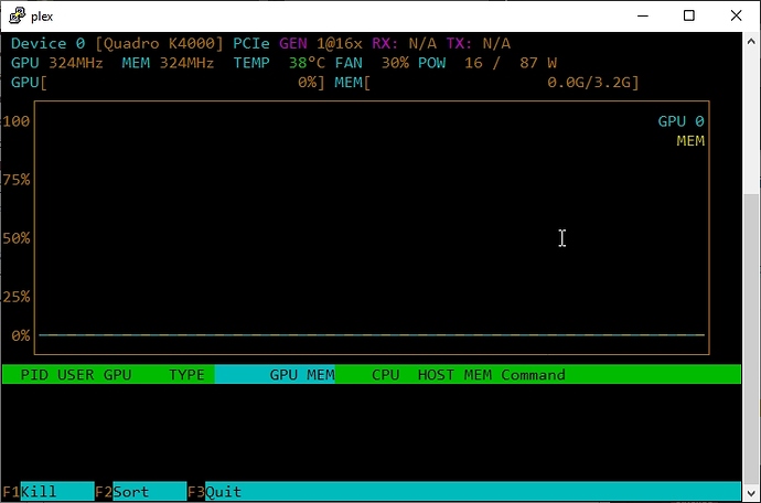

I can see in Tautilli that one of the server streams running is a trancode so I ran nvtop and it showed 0 GPU load & no processes running.

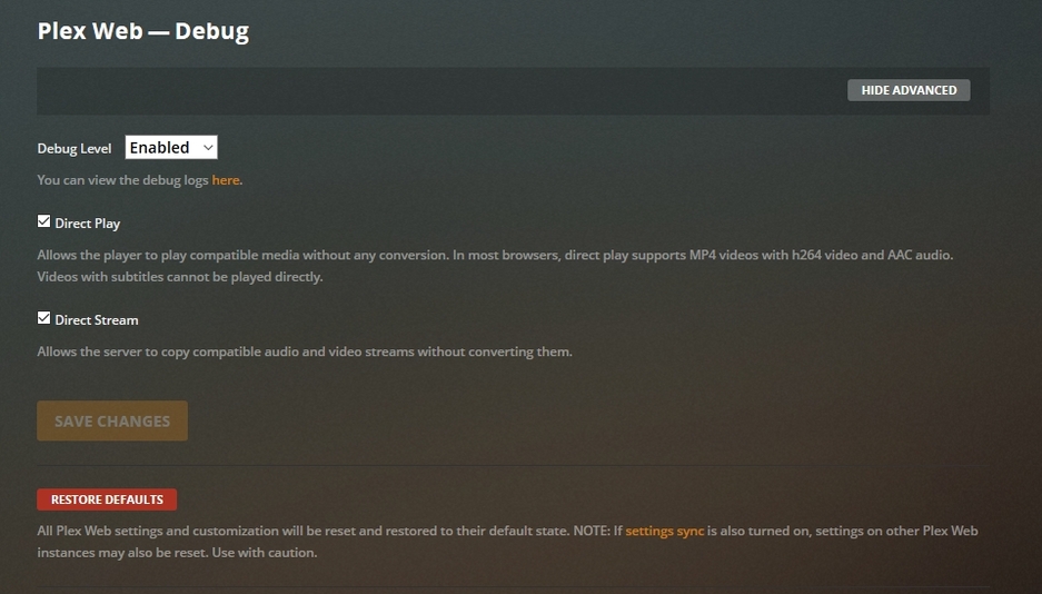

It’s not staying active.
DEBUG on,
VERBOSE off
SAVE
(watch for errors)

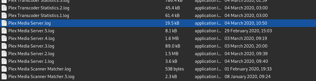

A transcode is happening now. See attached pic. Logs also attached - I don’t see any GPU activity in nvtop.
Any ideas?transcode Plex Media Server Logs_2020-03-04_10-56-18.zip (901.0 KB)

Attached is a pic from the server - is debug set correctly? Also attached is the output of the ‘You can view debug logs here’.
you can view debug logs here.txt (58.3 KB)

these are the log settings

in summary, you are getting HW transcoding, the nvtop isn’t going to show you anything because its not using the k4000 at all.
