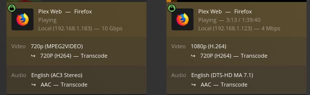

When I try and play something in a browser that will transcode, it doesn’t show the “hw” like the guides suggest:

If you go to activity and expand it, (refresh if needed) it will show ‘(hw)’
Still not seeing it show ‘hw’ when I expand the activity even after reloading the page.

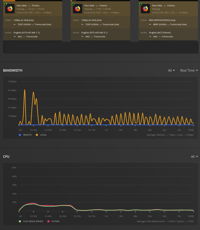

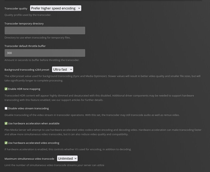

But I installed the 515 driver, so that’s 418 or newer even though the error says it needs newer?
$ sudo nvidia-smi
Tue Oct 25 00:01:31 2022
| NVIDIA-SMI 515.76       Driver Version: 515.76       CUDA Version: 11.7     |
| GPU  Name        Persistence-M| Bus-Id        Disp.A | Volatile Uncorr. ECC |
| Fan  Temp  Perf  Pwr:Usage/Cap|         Memory-Usage | GPU-Util  Compute M. |
|                               |                      |               MIG M. |
|   0  NVIDIA GeForce ...  Off  | 00000000:09:00.0 Off |                  N/A |
| 50%   30C    P8    N/A /  75W |     97MiB /  4096MiB |      0%      Default |
|                               |                      |                  N/A |
| Processes:                                                                  |
|  GPU   GI   CI        PID   Type   Process name                  GPU Memory |
|        ID   ID                                                   Usage      |
|    0   N/A  N/A      6328      C   ...diaserver/Plex Transcoder       47MiB |
|    0   N/A  N/A      6421      C   ...diaserver/Plex Transcoder       47MiB |

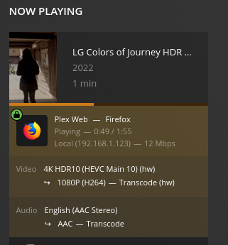

Here is a test file.
Create an Other Videos/Home videos library section for it.

To confirm - All 3 of your transcoder settings for hardware are enabled ?
(Show Advanced)
One thing to be advised of. It will not show (hw) if you’re burning subtitles even though it will for part of the process.
This is why I’m sharing a file which is known to yield the desired results.
I think the settings are all enabled correctly under Settings > Transcoder.

Played 30 seconds into the sample LG 4K video (buffered ~2 times to total file is slightly longer) and then stopped.
Plex Media Server Logs_2022-10-25_01-59-40.zip (3.3 MB)
Glad to try any other ideas you have or learn what I’m missing.

Also now my CPU utilization is practically zero while transcoding even that 4K stream, and zero buffering!
I also tried 2 BluRays and a HDHomeRun TV stream, still only <20% peak CPU use!
Also nvidia-smi now shows more resources on the GPU being consumed
