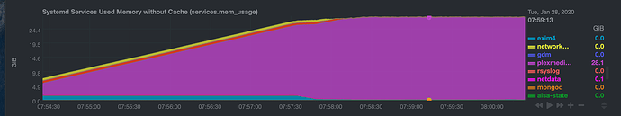

This morning, while I was asleep, plexmediaserver exploded in memory usage eating all system and paging memory available. Here’s a netdata screen shot:

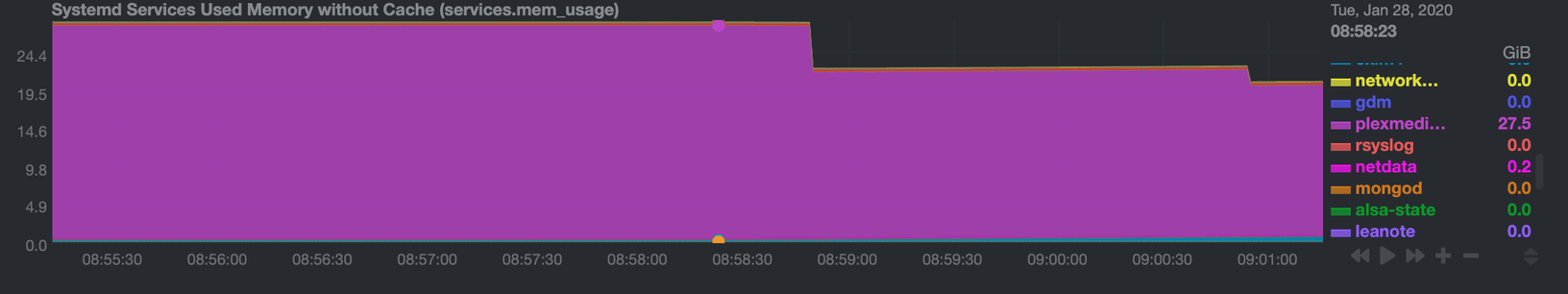

Plex kept this memory for approximately an hour before it started releasing it:
