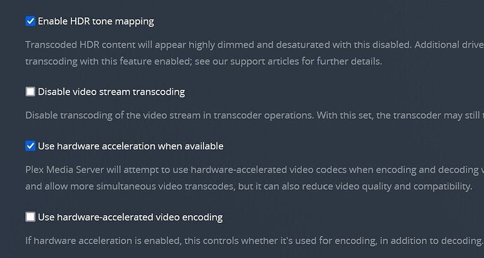

I find the combination of transcoding options in attachment works OK - not full transcoding, but offloads some of it. I f I enable the “use hardware accelerated video encoding” then it uses no Intel h/w to transcode at all and has also hung PMS in the past.

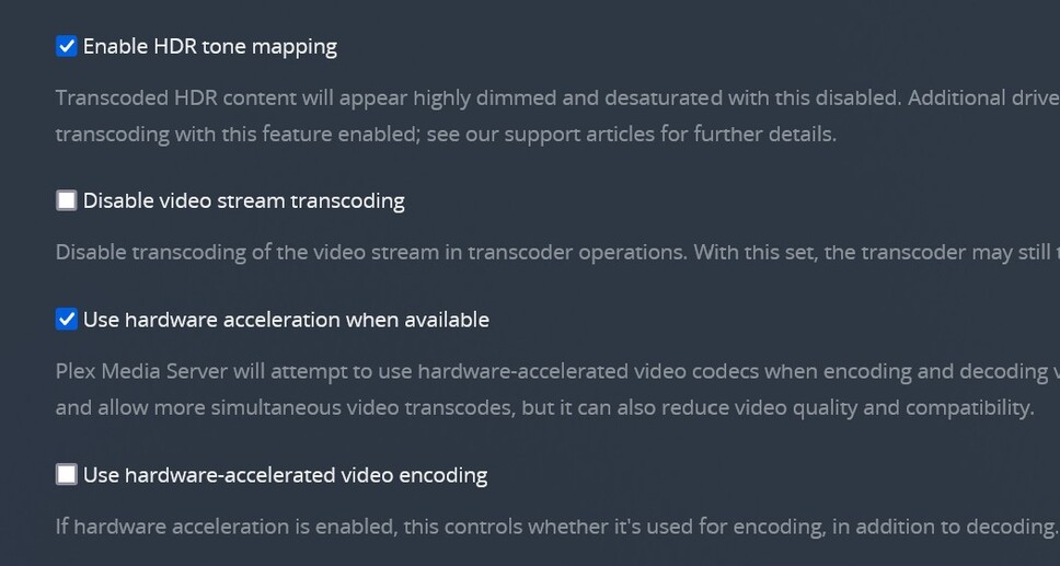

No change, but as JustinHow has noted, if you select the option not to encode, then it at least returns the hw decode option.
Just the use hardware acceleration enabled, and use hardware accelerated video encoding disabled
Compared to having both enabled and getting absolutely no hardware decode or encode
It definitely seems to try though
