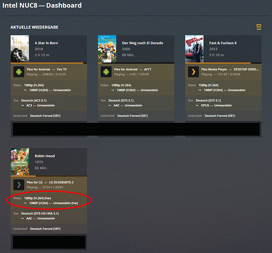

When I start a movie with 1080p limit, the hw transcoder fails. If I switch to 720p during playback, hw transcoding will turn on. If I change back to 1080p or automatically, the HW Transcoder fails again and the software takes over.
Feb 27, 2019 18:05:34.526 [1652] ERROR - [Transcoder] [h264_qsv @ 03f2d300] Error during encoding: device failed (-17)
Feb 27, 2019 18:05:34.526 [9196] ERROR - [Transcoder] Video encoding failed
Feb 27, 2019 18:05:34.604 [3464] DEBUG - TPU: hardware transcoding: enabled, but no hardware decode accelerator found
My attached log file contains two launches of the same movie. The first one works with hw transcoding. The second one, just seconds later, fails again.
