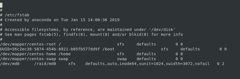

so i just write the line like this?
/dev/md0      /raid/md0     xfs    defaults,inode64,sunit=1024,swidth=3072,nofail   0 2
I like to add auto as well but YES, that’s it :slight_smile:
NOW it’s close :wink:
so modified the file like so. and this is where i am at now

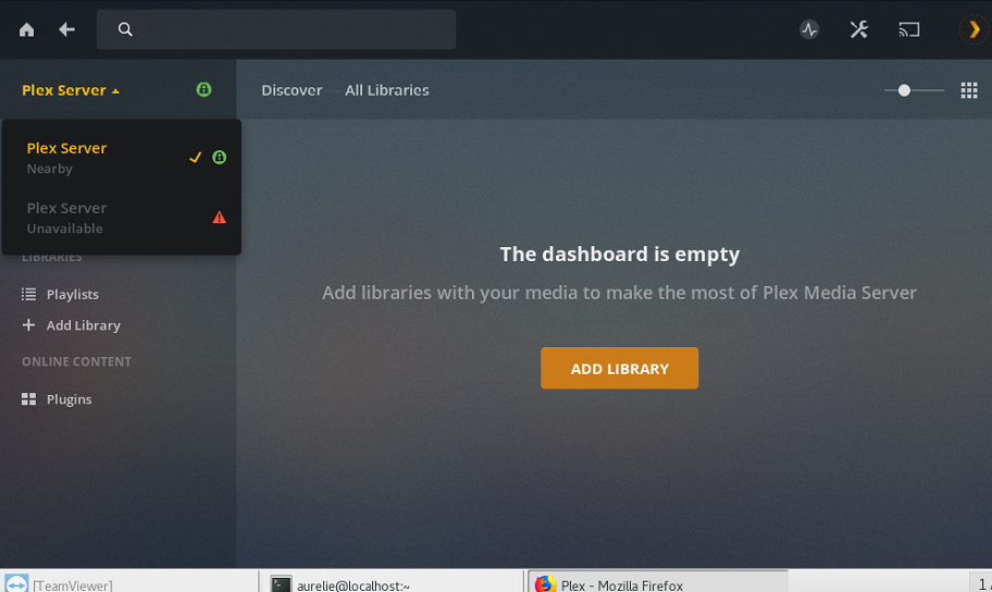

but decided to go with step 4
i now have 2 servers. the online one with no libraries on centos, and the offline one with all my libraries on windows.
my thinking is, should i turn on my windows one to get it online, then from my centos dashboard change the libraries paths to point to the libraries to my centos?
would that work? i’m not even sure i’m making sense at this point :joy:
edit: should i copy my registry from windows (HKEY_CURRENT_USERSoftwarePlex, Inc.Plex Media Server) to the preferences.xml on my centos?
at this point i’m kind of ready to do anything not to start from scratch and loose my 6 years old data. i might consider doing a sacrifice of a virgin on a full moon if that’s what it takes :rofl:

So if I understand correctly, seeing 2 servers (the windows and the centos) instead of 1, is a problem with my permissions?
The windows server is no more. Correct?
If it is gone: Settings - Device - Servers - Delete the Windows one. (longer time since seen)’
This isn’t a permissions problem… It is a simple Naming problem. Deconflict the naming and all will be good
