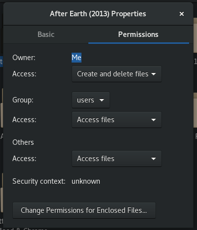

Through the GUI:
The Gnome GUI isn’t as robust as the Synology or QNAP GUI because it isn’t customized for large amounts of files but, by selecting multiple files/folders, you can achieve the same goal.
Screenshot%20from%202019-01-28%2021-10-28

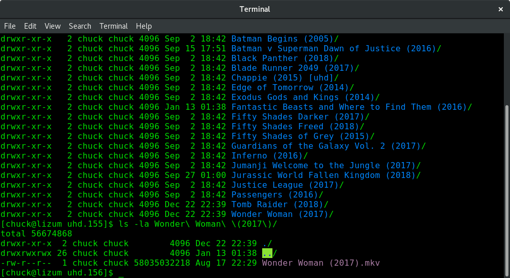

Since a picture is worth a thousand words, here is a snippet of how I have my media and directory permissions set. (the same 755/644 I stated above)

When I had the Linux machine here I tried adjusting the permissions using the GUI pictured above and it didn’t work. Tried to give all users read permissions. Nothing. Then read/write. Nothing. That said at this point I need to get the machine back to really get into it again… But I can say I got pretty lost when you started talking binary bits, base 8 and so on. I don’t have to give specific file permissions for each individual file, do I? Can’t I just give blanket permissions for a folder and it’s subfolders?
I never give specific permissions. There is no need to.
I have three values for media:
  1. owner of the files (me) chuck:chuck
  2. permissions for the directories 755
  3. permissions for the files 644
As example on how to implement on /disks/WD_8T_1, which I’ve formatted as ext4 (more on that later)
sudo chown -R chuck:chuck /disks/WD_8T_1
find /disks/WD_8T_1 -type d -exec chmod 755 {} \;
find /disks/WD_8T_1 -type f -exec chmod 644 {} \;
What this does is:
  1. Regardless who the owner of the files on the drive are now, as root user set chuck:chuck as the owner.
  2. Now that the files are under my name, tell find to find all the files of type directory and execute chmod 755 on each of them.
  3. Repeat the find command except have it find all the files of type file (regular files) and execute chmod 644 on each of them.
All the media in that directory (a whole disk actually) is now set for Plex use.
