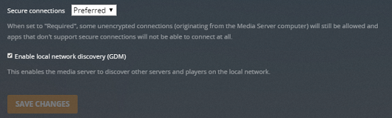

Do you know if I not using https under custom server access then PMS considers this an insecure connection though?
Also strangely the current status of my PMS looks like below with the custom server url added, when accessed via app.plex.tv/desktop:
EDIT: This seemed to be working but after a while it seems to become unavailable again. Like above the public IP is my actual WAN address so I am still confused.
