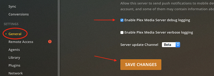

Before I paste all of what just happened, I’m going to request that you enable
debug mode and save, then don’t turn it off. It’s perfectly okay to leave it on
for a few days while we work this out.

So I guess run the test again, with debug mode on. If the CPU being bogged down is causing the transcoder to error about Parsed_inlineass_2 font problems, I can’t speak to that.

Hi mate,
you were absolutely right! it was not enabled because
i was a dumbarse!
I will upload the logs in a few min
Many thanks for your help
MM
