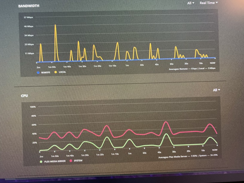

Not sure exactly when this problem started but it has never behaved like this before. The issue is that when i play something it starts ok but after a while (few minute) and sometime even from start in some cases the played (on my LG Tv) starts to show buffering.
Right now when i play a movie it plays 2 second and stops 1 second like its “hacking”. As if the data is not being transcoded or delivered to the player in time or something.
Not fully sure when the problem started. Could be a few plex server updates before. Could also be the player itself on the tv which was also updated recently. Sadly i cant downgrade.
I know for sure its not performance on the QNAP since i use barely 25% of the CPU and i have atleast 8 GB of RAM free.
As an example i played this:
and on plex dashboard i see this (dont show much load):
I removed all the logs since there were allot of files and played the movie when the issue happened. Also restarted Plex server on NAS + TV to be sure.

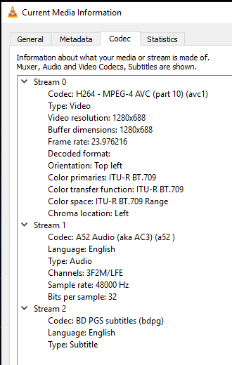

I read also that subtitles cause issue here (looked into other threads too but didnt find anything that helps):
Although i never had any issue until just recently. I have the “Burn Subtitles” on Automatic and tried “only image” as well but didnt help. But for sure i dont get the lag or buffering when i remove the subtitle. Considering my PC has lots more power and i have plenty of RAM i dont get why it lags.

Oct 16, 2019 20:20:03.252 [0x7f0003159700] DEBUG - MDE: The Art of Self-Defense (2019): selected subtitle cannot be converted to a compatible format, burning into video stream
So it wants to burn the PGS subs in that file, as they are image based subs. The better type of subs to have would be SRT. Anyway subtitle burns require the video to be transcoded on the CPU.

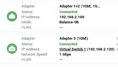

I’m curious what these addresses are that it’s finding and why they have these names:
Oct 18, 2019 23:18:08.747 [0x7fc421a04740] DEBUG - Detected primary interface: 192.168.2.100
Oct 18, 2019 23:18:08.747 [0x7fc421a04740] DEBUG - Network interfaces:
Oct 18, 2019 23:18:08.747 [0x7fc421a04740] DEBUG -  * 1 lo (127.0.0.1) (loopback: 1)
Oct 18, 2019 23:18:08.747 [0x7fc421a04740] DEBUG -  * 6 bond0 (192.168.2.100) (loopback: 0)
Oct 18, 2019 23:18:08.747 [0x7fc421a04740] DEBUG -  * 11 br0 (192.168.2.120) (loopback: 0)
I think my QNAP uses en0 and lo.

I’m curious about the adapter names as well.
  1. bond0 = first bonded adapter
  2. br0 = first (and pre-created) virtual bridge adapter
QTS 4.3 and above use eth for the adapter and qvs for the virtual switch names.
I have the 4 onboard (eth0 - eth3), the 10 GbE at eth4. eth4 feeds the virtual switch and IP is attached to qvs0.
Had you not stated this is QNAP, I would have presumed Synology or other distribution.
To the matter at hand, given both bond0 and br0 are on the same subnet, default TCP packet handling is going to try and use both if the destination is also on 192.168.2.x
It does this because the configuration defaults to a metric (cost) of 1. Linux will always favor the path with the lowest cost. If cost is the same for two paths, it will assume both are valid and use both.
This could easily be the lag you’re seeing because it’s attempting to send on br0 which likely goes nowhere. Not being able to resend, it jumps back to bond0 and then ultimately does get sent.
Does this seem to describe what is being seen?
Thanks for the findings. Not sure i understand every detail but to explain about my network setup i can share this :
Basically my NAS uses 2 ETH port in trunked mode (192.168.2.100).
My VM’s uses the other address 192.168.2.120 (as you say feeds my virtual switch). So Plex should always be using 192.168.2.100.
I never changed anything and it use to work before but maybe my network configuration is wrong to begin with. Appreciate some tips. I have QTS 4.4.1.
I have looked through the settings and cant see what i should change to be honest.
