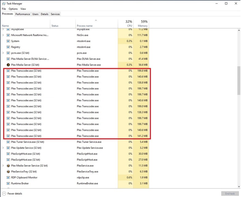

Recently Plex started spawning multiple and numerous “Plex Transcoder.exe” processes on the server. The last screenshot I was able to get shows a total of ~92 of these processes running each consuming 6.4 Mb of memory. I’ve attached a dump from Process Explorer showing all the processes running at the time. I don’t realize this until the server starts behaving weird (inability to Remote Desktop into the server, unable to open Task Manager from console, etc.). Essentially it consumes all resources on the server to the point where I have to hard power off the server because it’s not responding.

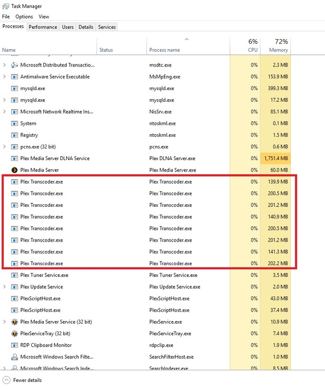

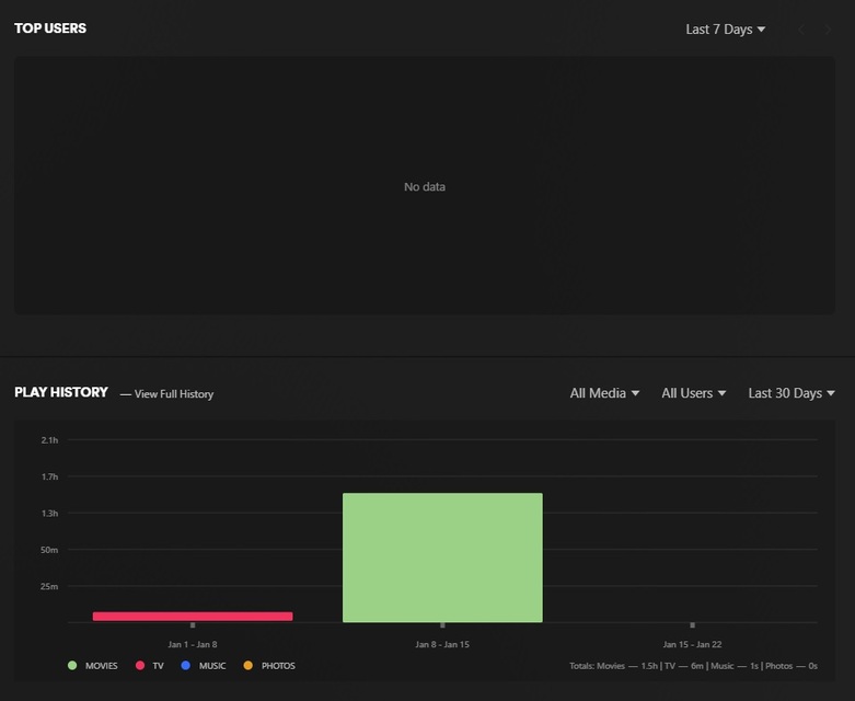

Attached are 2 screenshots - 1st one of Task Manager showing 12 “Plex Transcoder.exe” processes running, and the 2nd of Plex showing Top Users and Play History. This is 5 days after a server reboot and ZERO Plex client usage in that timeframe, as shown in the 2nd screenshot. There’s no reason for the transcoder to even be running if there are no clients streaming from it. As a reminder, I already changed “Maximum simultaneous video transcode” from the default of “Unlimited” down to “2”, but that clearly has no effect here.
