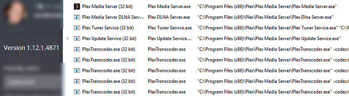

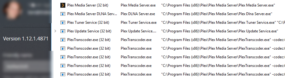

Well… that was fast - I still have the issue after upgrading to 1.12.1.4871.
Shortly after upgrading, I restarted the PC (unrelated) and when working on something else, noticed the PC was sluggish. I looked in task manager to find 5 PlexTranscoder.exe processes - one of which was using ~80% CPU. For any potential doubters out there, I’ve also included a screenshot of “Now Playing” to show nothing was being played, synced, etc at the time this occurred. Once I closedPMS, everything went back to normal. Otherwise, the number of these processes would have grown a bit more.
Can someone please advise on what this is and how to resolve it!?!
It was mentioned in an earlier reply that a similar issue was reported ~5 releases ago. What it a confliction with something I can resolve like uninstalling a specific Windows 10 update?
Happy to submit any specific logs if needed.
Thanks!
