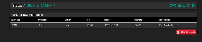

Go to Status → NAT-PMP
This is my development DS418 system. The port was allocated by PMS in automatic mode.

I see no entries in UPnP status, but I currently have Plex to manually use 32400, not “auto” in the remote access settings page of Plex. Perhaps the UPnP works if you DON’T have manual port forwarding set up?
Then Plexamp has a problem… I can’t help with that.
I don’t have Windows here either. I’m strictly Linux.
UPnP does work if you turn off the manual port.
Let it pick a port number.
Yep, disabled manual port selection in PMS settings and now I can see a UPnP entry in pfSense UPnP status page. But even this way, Plexamp isn’t working. ¯_(ツ)_/¯
