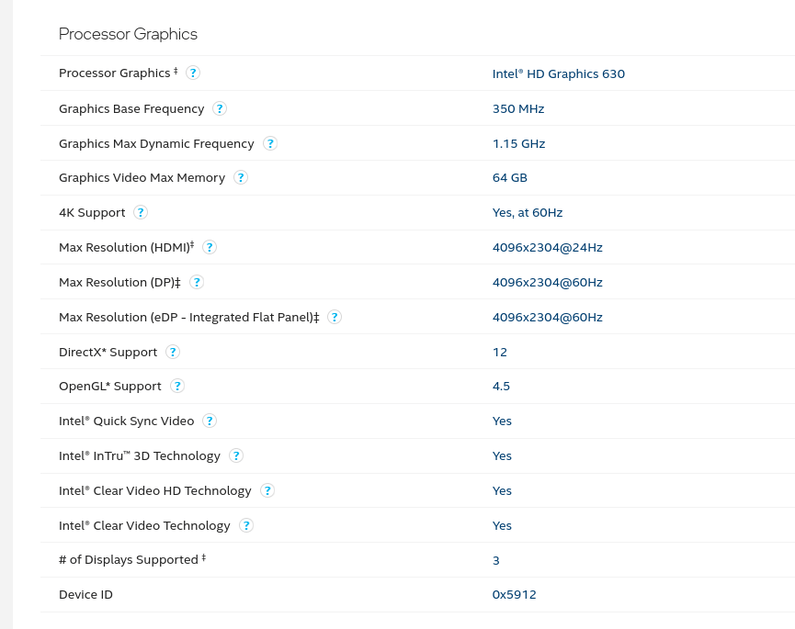

@npmw10533
Quick Sync:
Almost all Intel “Core” CPUs since the -2000 series have Quick Sync Video capability.
There are some which don’t. There are additional attribute letters assigned to the CPU SKU for them.
The Intel CPU information archive https://ark.intel.com
If you search there, providing your CPU info (e.g. i7-7700), it will list all the technical capabilities of the chip.
To determine if it has Quick Sync Video capability is to search for it listed on the page.
As example: Search for i7-7700 (no suffix character)
Scroll down and you will find this:
In the Plex context of transcoding 4K, there is a generation dependency added.
The QSV version which first gave us this capability is the Intel UHD 630 graphics as it can transcode 2160p UHD HEVC → 1080p SDR H.264.
“Intel Quick Sync Video: Yes”
As additional confirmation of its capabilities, notice
“Processor Graphics: Intel HD Graphics 630” (commonly known as ‘UHD 630’)
The most common, and first, CPU SKU which gave us hardware decoding of 2160p UHD HEVC is the -7xxx CPU. (e.g i3-7300, i5-75000, and i7-7700)
The CPUs can, in hardware convert HEVC HDR → HEVC SDR. At the moment, Plex is not licensed for writing HEVC output. This is why H.264 is used as Plex does hold that license.
