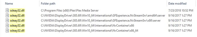

Could you check this file properties and let me know file ./ product version from the file properties screen
C:\Program Files (x86)\Plex\Plex Media Server\ssleay32.dll

Also search the C: drive for ssleay32.dll and let me know what you find and where

ssleay32.dll product version is 1.0.2j
Here is the env_vars_2018-Aug-02.txt (1.5 KB)
Also I took a screenshot of the ssleay32.dll search results and it is below.
Thanks again for all the help and please let me know anything else I can do.
-John
