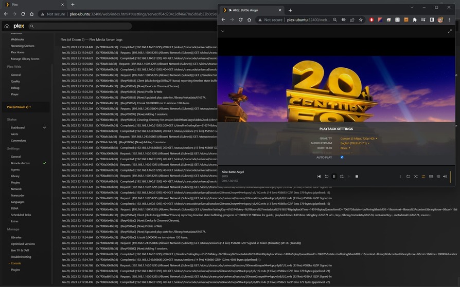

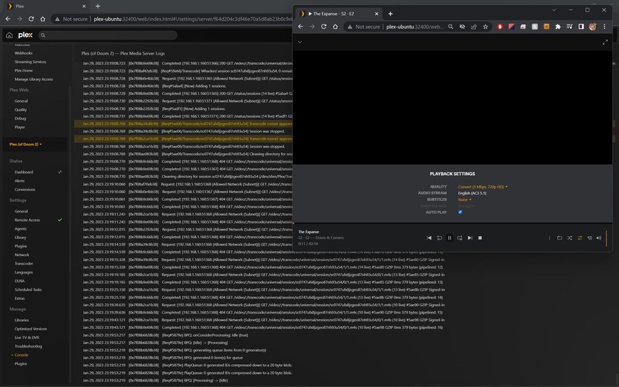

The problem I’m seeing is that when I force a transcode, it has a 50/50 chance of it working. In that the client just sits there showing nothing. And the logs seem to just show FFMPEG/Transcoder just quiting itself? If I just pick another mbps a few times, it all kicks in and works?
(firing up my vm snapshot now)
Just about your subtitles question… In the screenshots I posted earlier, they were set to none?
So I’ve changed the TranscoderLogLevel back to Error. Went to play a film, and it remembered to play at 2mbps, it fired up and seemed to be transcoding fine. I then just switched to another mbps and it just fell over again :man_shrugging:

Jan 30, 2023 00:09:04.216 [0x7f3eccf82b38] DEBUG - [Req#aa65/Transcode] Cleaning directory for session oqiydjxj0poespkmb52rngmm (/dev/shm/Plex/Transcode/Sessions/plex-transcode-oqiydjxj0poespkmb52rngmm-f7c55f90-4090-4933-bfd4-9a6d6f9b592a)
Why is PMS killing the transcode job? But it was already PUTting files in the session folder?
Jan 30, 2023 00:09:05.785 [0x7f3ecc96cb38] DEBUG - [Req#a688/Transcode] Codecs: 10-bit HEVC test succeeded
Jan 30, 2023 00:09:05.842 [0x7f3ecc96cb38] DEBUG - [Req#a688/Transcode] Alita: Battle Angel - audio.channels limitation applies: 8 > 6
Jan 30, 2023 00:09:05.842 [0x7f3ecc96cb38] DEBUG - [Req#a688/Transcode] MDE: Cannot direct stream audio stream due to profile or setting limitations
Jan 30, 2023 00:09:05.842 [0x7f3ecc96cb38] DEBUG - [Req#a688/Transcode] MDE: Alita: Battle Angel (2019): selected media 0 / 933026
Jan 30, 2023 00:09:05.842 [0x7f3ec9311b38] DEBUG - [Req#a688/Transcode] Killing job.
Jan 30, 2023 00:09:05.842 [0x7f3ec9311b38] DEBUG - [Req#a688/Transcode] Signalling job ID 3322 with 9
Jan 30, 2023 00:09:05.842 [0x7f3ec9311b38] DEBUG - [Req#a688/Transcode] Job was already killed, not killing again.
Jan 30, 2023 00:09:05.842 [0x7f3ec9311b38] DEBUG - [Req#a688/Transcode] Stopping transcode session pbwqgmvk6amu87r86c4twb10
Jan 30, 2023 00:09:05.842 [0x7f3eccb6fb38] DEBUG - [Req#a688/Transcode] Cleaning directory for session pbwqgmvk6amu87r86c4twb10 (/dev/shm/Plex/Transcode/Sessions/plex-transcode-pbwqgmvk6amu87r86c4twb10-c3eb0a01-ecdd-4d66-b249-a18ecd264133)
Jan 30, 2023 00:09:05.842 [0x7f3ecc96cb38] DEBUG - [Req#a688/Transcode] Streaming Resource: Reached Decision id=616574 codes=(General=1001,Direct play not available; Conversion OK. Direct Play=3000,App cannot direct play this item. Direct play is disabled. Transcode=1001,Direct play not available; Conversion OK.) media=(id=933026 part=(id=998584 decision=transcode container=mp4 protocol=dash streams=(Video=(id=1874346 decision=transcode bitrate=3676 encoder=h264_nvenc width=1280 height=720) Audio=(id=1874347 decision=transcode bitrate=119 encoder=aac channels=2 rate=48000))))
Jan 30, 2023 00:09:05.843 [0x7f3ec9311b38] DEBUG - [Req#a688/Transcode] Transcoder: Cleaning old transcode directories.
Client clearly doesn't know what is going on, or ddn't got the memo that the transcode was cancelled!?
The client is requesting the files, but is getting a 404, because the job was cancelled and a clean-up started
Jan 30, 2023 00:09:06.035 [0x7f3ed111fb38] DEBUG - Completed: [192.168.1.160:52621] 404 GET /video/:/transcode/universal/session/pbwqgmvk6amu87r86c4twb10/0/header (13 live) #b046 GZIP 1101ms 379 bytes (pipelined: 3)
Jan 30, 2023 00:09:06.035 [0x7f3ecd58bb38] DEBUG - [Req#b04d/Transcode] Deleting stale file "/tmp/pms-77bd91d5-b74b-46d1-a25c-c0118a8883b8/EasyAudioEncoder/Convert to WAV (to 8ch or less)/pbwqgmvk6amu87r86c4twb10_3322-0-9.mlp"
Jan 30, 2023 00:09:06.035 [0x7f3ecd58bb38] DEBUG - [Req#b04d/Transcode] Deleting stale file "/tmp/pms-77bd91d5-b74b-46d1-a25c-c0118a8883b8/EasyAudioEncoder/Convert to WAV (to 8ch or less)/pbwqgmvk6amu87r86c4twb10_3322-0-9.wav"
Jan 30, 2023 00:09:06.036 [0x7f3ed111fb38] DEBUG - Completed: [192.168.1.160:52620] 404 GET /video/:/transcode/universal/session/pbwqgmvk6amu87r86c4twb10/1/header (13 live) #b04d GZIP 1102ms 379 bytes (pipelined: 3)
Jan 30, 2023 00:09:06.569 [0x7f3ecc96cb38] DEBUG - Request: [192.168.1.160:52620 (Allowed Network (Subnet))] GET /video/:/transcode/universal/session/pbwqgmvk6amu87r86c4twb10/1/header (13 live) #b41b GZIP Signed-in
Jan 30, 2023 00:09:06.569 [0x7f3ed111fb38] DEBUG - Completed: [192.168.1.160:52620] 404 GET /video/:/transcode/universal/session/pbwqgmvk6amu87r86c4twb10/1/header (13 live) #b41b GZIP 0ms 379 bytes (pipelined: 4)
Jan 30, 2023 00:09:06.905 [0x7f3eceaf6b38] DEBUG - Request: [192.168.1.160:52620 (Allowed Network (Subnet))] GET /video/:/transcode/universal/session/pbwqgmvk6amu87r86c4twb10/0/header (13 live) #b420 GZIP Signed-in
Jan 30, 2023 00:09:06.906 [0x7f3ed111fb38] DEBUG - Completed: [192.168.1.160:52620] 404 GET /video/:/transcode/universal/session/pbwqgmvk6amu87r86c4twb10/0/header (13 live) #b420 GZIP 0ms 379 bytes (pipelined: 5)
Jan 30, 2023 00:09:07.592 [0x7f3ecb563b38] DEBUG - Request: [192.168.1.160:52620 (Allowed Network (Subnet))] GET /video/:/transcode/universal/session/pbwqgmvk6amu87r86c4twb10/1/header (13 live) #b424 GZIP Signed-in
Jan 30, 2023 00:09:07.593 [0x7f3ed1322b38] DEBUG - Completed: [192.168.1.160:52620] 404 GET /video/:/transcode/universal/session/pbwqgmvk6amu87r86c4twb10/1/header (13 live) #b424 GZIP 0ms 379 bytes (pipelined: 6)
Jan 30, 2023 00:09:08.654 [0x7f3ecc198b38] DEBUG - Request: [192.168.1.160:52620 (Allowed Network (Subnet))] GET /video/:/transcode/universal/session/pbwqgmvk6amu87r86c4twb10/0/header (13 live) #b42a GZIP Signed-in
Jan 30, 2023 00:09:08.654 [0x7f3ed111fb38] DEBUG - Completed: [192.168.1.160:52620] 404 GET /video/:/transcode/universal/session/pbwqgmvk6amu87r86c4twb10/0/header (13 live) #b42a GZIP 0ms 379 bytes (pipelined: 7)
Jan 30, 2023 00:09:10.650 [0x7f3ecc198b38] DEBUG - Request: [192.168.1.160:52620 (Allowed Network (Subnet))] GET /video/:/transcode/universal/session/pbwqgmvk6amu87r86c4twb10/1/header (13 live) #b42f GZIP Signed-in
Jan 30, 2023 00:09:10.650 [0x7f3ed1322b38] DEBUG - Completed: [192.168.1.160:52620] 404 GET /video/:/transcode/universal/session/pbwqgmvk6amu87r86c4twb10/1/header (13 live) #b42f GZIP 0ms 379 bytes (pipelined: 8)
Jan 30, 2023 00:09:14.602 [0x7f3ecc198b38] DEBUG - Request: [192.168.1.160:52620 (Allowed Network (Subnet))] GET /video/:/transcode/universal/session/pbwqgmvk6amu87r86c4twb10/0/header (13 live) #b434 GZIP Signed-in
Jan 30, 2023 00:09:14.602 [0x7f3ed1322b38] DEBUG - Completed: [192.168.1.160:52620] 404 GET /video/:/transcode/universal/session/pbwqgmvk6amu87r86c4twb10/0/header (13 live) #b434 GZIP 0ms 379 bytes (pipelined: 9)
Jan 30, 2023 00:09:21.160 [0x7f3ecc198b38] DEBUG - Request: [192.168.1.160:52620 (Allowed Network (Subnet))] GET /video/:/transcode/universal/session/pbwqgmvk6amu87r86c4twb10/0/header (13 live) #b439 GZIP Signed-in
Jan 30, 2023 00:09:21.160 [0x7f3ed111fb38] DEBUG - Completed: [192.168.1.160:52620] 404 GET /video/:/transcode/universal/session/pbwqgmvk6amu87r86c4twb10/0/header (13 live) #b439 GZIP 0ms 379 bytes (pipelined: 10)
Jan 30, 2023 00:09:22.057 [0x7f3ecc198b38] DEBUG - Request: [192.168.1.160:52620 (Allowed Network (Subnet))] GET /video/:/transcode/universal/session/pbwqgmvk6amu87r86c4twb10/1/header (13 live) #b456 GZIP Signed-in
Jan 30, 2023 00:09:22.057 [0x7f3ed1322b38] DEBUG - Completed: [192.168.1.160:52620] 404 GET /video/:/transcode/universal/session/pbwqgmvk6amu87r86c4twb10/1/header (13 live) #b456 GZIP 0ms 379 bytes (pipelined: 11)
Jan 30, 2023 00:09:34.911 [0x7f3ecc198b38] DEBUG - Request: [192.168.1.160:52620 (Allowed Network (Subnet))] GET /video/:/transcode/universal/session/pbwqgmvk6amu87r86c4twb10/0/header (10 live) #b45b GZIP Signed-in
Jan 30, 2023 00:09:34.911 [0x7f3ed1322b38] DEBUG - Completed: [192.168.1.160:52620] 404 GET /video/:/transcode/universal/session/pbwqgmvk6amu87r86c4twb10/0/header (10 live) #b45b GZIP 0ms 379 bytes (pipelined: 12)
Me stopping the "attempted" playback, even though it was stopped for no reason?
Jan 30, 2023 00:09:41.942 [0x7f3ecc198b38] DEBUG - Request: [192.168.1.160:52620 (Allowed Network (Subnet))] GET /:/timeline?ratingKey=616574&key=%2Flibrary%2Fmetadata%2F616574&playbackTime=67761&playQueueItemID=706975&state=stopped&hasMDE=1&context=library%3Acontent.library&row=1&col=1&time=30000&duration=7317000 (10 live) #b463 GZIP Signed-in
Jan 30, 2023 00:09:41.942 [0x7f3ecc198b38] DEBUG - [Req#b463] Client [n3gvx3lq78qnwl8alrjwtj9n] reporting timeline state stopped, progress of 30000/7317000ms for guid=, playbackTime=67761ms ratingKey=616574 url=, key=/library/metadata/616574, containerKey=, metadataId=616574, source=
Why is this transcode session still cleaning something? Seems a bit odd?
Jan 30, 2023 00:09:42.066 [0x7f3ecc198b38] DEBUG - [Req#b463] Cleaning directory for session oqiydjxj0poespkmb52rngmm (/dev/shm/Plex/Transcode/Sessions/plex-transcode-oqiydjxj0poespkmb52rngmm-f7c55f90-4090-4933-bfd4-9a6d6f9b592a)
The main bit for me is why is PMS stopping/killing it’s own transcode? It’s killing it off and the client is about to start asking for files?
