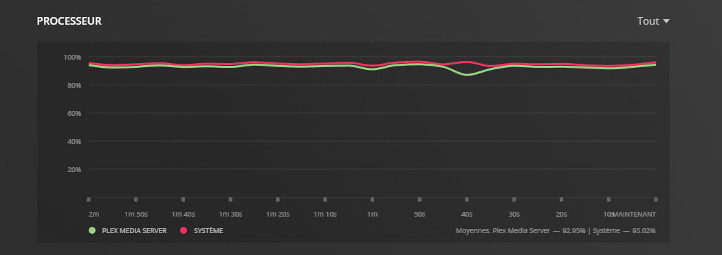

Don’t know if it has anything to do with latest update or not but those last weeks, I have the feeling my hardware transcoding is making more and more problems. Was working smoothly a month before.
The errors I have, have been seen for a while now but since yesterday, some videos I could flawlessly read before can not being played, toping my server’s CPU.
From the console, I can also notice that the “hw” tag is not present anymore, meaning the server tries to transcode with the CPU, despite seing a job in the nvidia-smi dashboard.
Any clue where I could start troubleshooting? Thanks in advance :slightly_smiling_face:

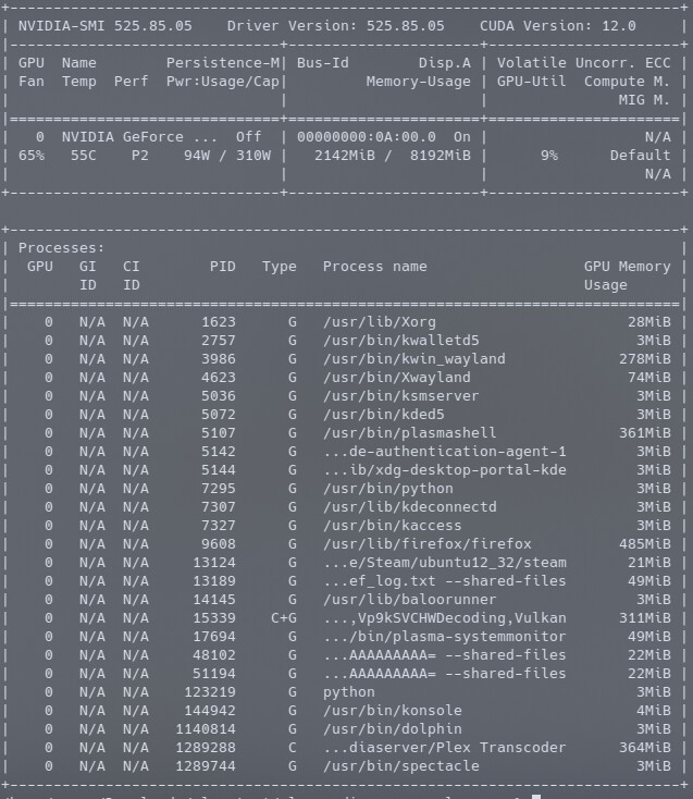

nvidia-smi during trying to play the file:

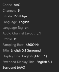

I’ve tried the same file(s) on Plex web and an iPad, I had the same errors as long as it needs to do transcoding:
Details of the file played:
I’ll rollback to the production version but if I need to test it again, no problem, let me know :wink:
