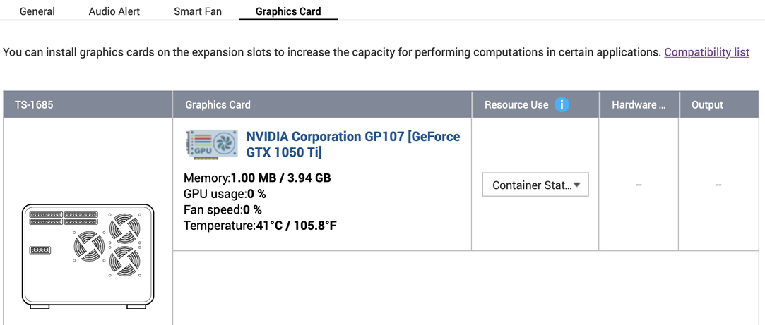

Both Nvida and Qnap are certainly passing access to coda cores through to containers. I think you recommendation in not using a container is ludicrous. I’ve been using a containerised version of plex for about 2 years now. There are loads of benefits to this model and it’s the way modern software has worked for at least a year now. Asking us to revert to really lame QPKG installs is definitely a step backward.
