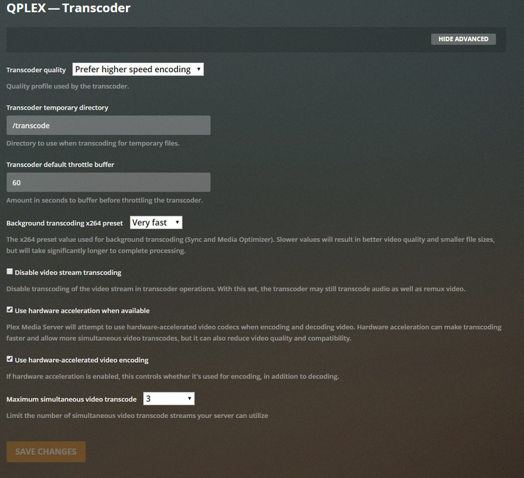

I have enabled hardware transcoding on thru UI:
When playing a video, i see CPU spike up w/o (hw) in transcode
What am I missing?

  11. Don’t forget to go to Settings->Transcoder, so you can enable the Hardware Transcoding settings:

  6. Play a video from your library. Choose a quality/bitrate that forces Plex to transcode it (higher or lower than the original bitrate, it doesn’t matter which.)
Once the video starts playing at the manually selected bitrate, you should now be able to view the details in the Plex dashboard. If everything worked, it’ll now say “Transcode (hw)”.

  1. Creating a copy of /dev/dri seems like it can be avoided if we can, somehow do a “post-container-create-before-plex-starts” to achieve that. I think it can be achieved in a docker file. Not sure how to achieve that in docker-compose.
    1a. It also begs the question, about needing to this at all. (may be it’s a QNAP-non-container-station-solution)
  2. getting named volumes working. I really like the idea of having a well known plex volumes so it’s easy to reuse across multiple containers. However, I am not sure on how to achieve that… i.e. not have docker create that volume but use an existing one.
Also, thanks for the tip on Container Station create… I like it at least as an editor+validtator.
For reference, here’s my docker-compose file:
version: '2'
services:
  plex:
    container_name: qplex
    image: plexinc/pms-docker
    restart: unless-stopped
    network_mode: bridge
    devices:
      - /dev/dri:/dev/dri
    ports:
      - 32400:32400/tcp
      - 3005:3005/tcp
      - 8324:8324/tcp
      - 32469:32469/tcp
      - 32900:1900/udp
      - 32410:32410/udp
      - 32412:32412/udp
      - 32413:32413/udp
      - 32414:32414/udp
    environment:
      - TZ="America/New_York"
      - PLEX_CLAIM=<myclaim>
      - ADVERTISE_IP=http://<myIP>:32400/
      - HOME="/config"
      - VERSION="latest"
      - PLEX_UID=1001
      - PLEX_GID=1000
    hostname: QPLEX
    volumes:
      - /share/Container/docker_configs/plex/qplex:/config
      - /share/Container/docker_configs/plex/qplex/transcode/temp:/transcode
      - /share/MEDIA:/data/media:ro
      - /share/Container/docker_configs/plex/hw_transcode_workaround/dev/dri:/dev/dri
Some notes on the above:
  • I created a user plexuser and a plexgroup
  • plexuser has readonly access to media
  • I did chown -R plexuser:plexgroup to /plex/hw_transcode_workaround/dev/dri
