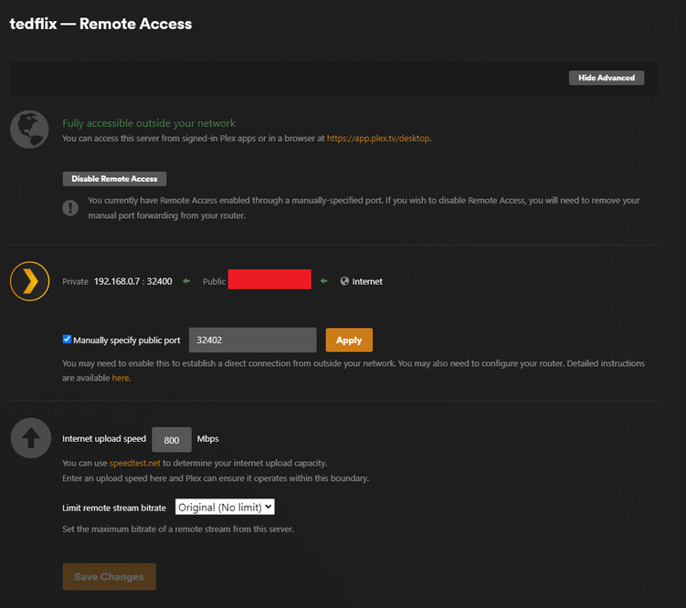

Is it working nice and steady for you again?
You’ll probably want to go through ALL your settings and fix them up.
I see Relay is running. You can turn it off if you have Remote Access fully working.
Happy Sunday @ChuckPa ,
I googled around on how to turn off relay but didn’t find anything.
I really do like the idea of having the DB in the home directory for nice backup and keeping it separate from the OS partition…great idea, should make things much smoother in the future, thank you for that tip and the settings that are needed for it.
Best,
Ted
Ted,
Settings - Server - Network - Show Advanced
@ChuckPa done! Thank you…everything has been running perfectly…can I PM/DM you I’d like to send you something…
