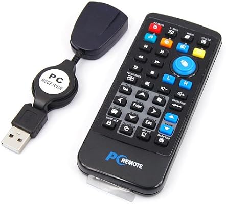

Where did you get the remote from for a £5 ?
I bought three of the following
They work out of the box with rasplex and work better than the gpio remote i used previously.
Not sure how long the remote controls will last but at least the kids and wife can now navigate the menus properly.
I have programmed my harmony remote to emulate the remote so i get to use a nicer remote and the kids have the cheapy remotes.
I believe they do a larger slightly more expensive version but cannot comment on that one.

Thank you that will be perfect
