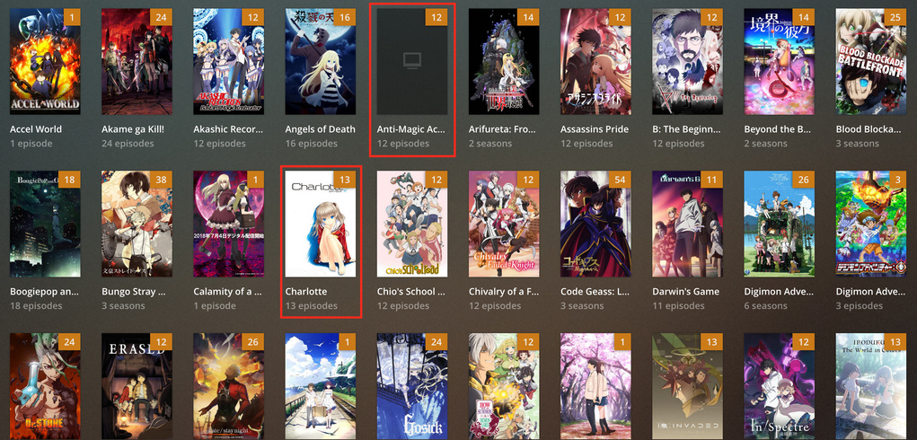

Experiencing some issues with some anime files incorrectly being named xxx [tvdb-01] and anime posters not using the ‘main’ poster from TVDB. I performed the troubleshooting steps, and despite clean installs and looking through the settings, the problems persist.
  • The anime showing xxx[tvdb-01] should be ‘A Silent Voice’. The file is named ‘A Silent Voice - 01 - Complete Movie.mkv’.
  • The anime without a poster and not being matched is Anti-Magic Academy 35th Test Platoon. I’ve tried to manually match through HAMA, but nothing appears. And when I manually match using TVDB, the correct option appears.
  • For the posters, animes like Charlotte, My Hero Academia, and others are not using the ‘main’ posters from TVDB. Perhaps I’m just misunderstanding how it works or my setting needs to be adapted, but the poster being displayed is different than the series poster shown on the TVDB website. Instead, it seems to either randomly or incorrectly prioritize another poster from the list.
  • A much smaller issue for me, but the collections option does not seem to be saving or is overlooked by the agent. I have the collections disabled and explicitly set collection to None in HAMA, but after initial build as well as rebuilds, collections still get created.
Thanks for any help.

@Montblac
  • Matching - This happens at scanner level if the title is only numbers as it takes it for a tvdbid, here it considered the title “01”. This is a scanner issue, i need scanner logs. You should custom search the series by hand, that would fix it…
  • Series poster - There is an algorythm to avoid poster duplicates if people use AniDB numbering otherwise all seasons and movies would carry the same poster.
  • Collections - "Prefs[collections ] = None " in your agent settings, which is why i can’t see a collection field set in the agent, so for me the setting is in the database already. Removing it in settings doesn’t remove it from the metadata…
