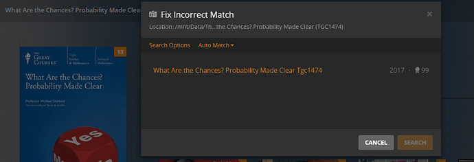

1 thing --> ? in title doesnt seem to enable matching, not even if manually matched on 99%… (I did image manually)
Example of image naming…
I fixed it by removing the ? from the folder name… for ref here is course: http://www.thegreatcourses.com/courses/what-are-the-chances-probability-made-clear.html

@GoingGaGa Yeah, I believe PLEX doesn’t handle ? in filenames because when I cam across that course, the logs weren’t even being populated when I tried adding the course. It seems PLEX might have halted sometime prior to the agent running. But, I can’t be sure that’s the problem.

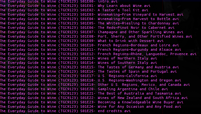

The agent would not process some of the episodes for “Everyday Guide to Wine” - TGC9123. Episodes 7 thru 10 would not pick up the metadata, episode name, and any artwork.
I also noticed that the episodes were not in numerical order on the disk - Lecture 9 was the first one, followed by 10, 7, & 8. Not sure what that was about.
@agglomerator Strange. Here is my list of files:
And here is my metadata for those lectures:
However, the log file points out an error. There are two listings for course number 9123 on the TGC+ website. When finding the lecture thumbs from the TGC+ website, my searchPlusURL() finds the first listing which links to the-everyday-guide-to-wines-of-california so it only grabs lecture images for those lectures (6 in total). This caused me to notice in my code there is no bounds check on lecture thumbs and would cause the agent to throw an exception and stop processing. However, metadata should still load for subsequent lectures as that occurs prior to the lecture thumbs. As you’ll notice my metadata loaded for those episodes.
Hold tight as I will make the adjustments to the code. I’ll let you know when bounds checks and an improved searchPlusURL() is made.
Thanks for point this out to me.
Bounds checking on lecture thumbs has been added. And I’ve updated the searchPlusUR() method to ensure correct TGC+ course page is found for downloading lecture thumbs.
