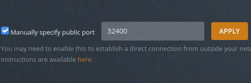

I recently upgraded to AT&T 1 gig fiber. I was given the BGW-320. It took me a bit to finally get remote access working and just wanted to see if this was correct:
… because it seemed doing anything else would cause connections to use indirect play and limit streamers to 2Mbps. If you have this ONT and Plex, does this mirror your settings?

I don’t use 32400, but looks correct.
