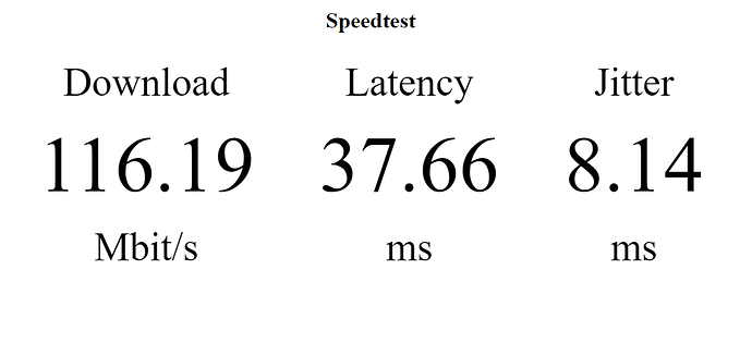

I only use the VPN to make changes in freenas, it’s deleted for all testing purposes. I don’t have iperf setup but I can run a speed test to the same server through my DVR and easily max out my download of 125Mbps on the client side

This is a speedtest provided by the dvr I use that pings the dvr server directly. My site-to-site vpn is disabled and I’m only limited by my download being 125Mbps, if I had a higher dl connection it would likely saturate my 200Mbps upload on the server side.
