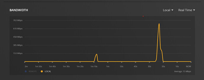

Start streaming one of those files. (Can be locally.)
Open a second browser tab with the web app and look at the Dashboard – specifically at the bandwidth graph.
Does it show insanely high bandwidth?
Thanks for responding.
I wouldn’t say it’s insanely high, but it does seems higher than it should be:
Jumps way high, but then averages at about 15Mbps.
No, that is kinda normal.
Because at playback start the buffer memory of the client is filled at max. speed.

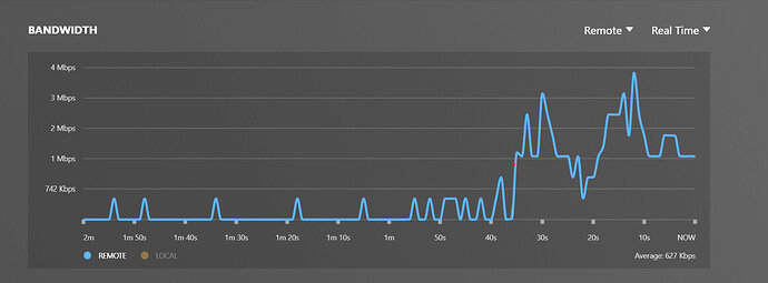

Monitor the Dashboard during a remote stream.
Does it say “Remote” or does it say “Indirect”?
(the latter would be bad)
Did you disable the transcoder?
What kind of CPU and GPU are in the server?
Dashboard says remote for remote streams.
I didn’t disable the transcoder (or at least I don’t think I did). To disable I’d check the Disable video stream transcoding box, right? It is not checked.
No GPU, I’m using an i5-10400 @ 2.90 GHz. Has been incredibly reliable thus far.
