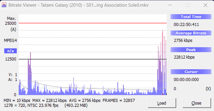

case in point: Tatami Galaxy (2010) has a rather plain drawing style, so the average bitrate is rather low.
But it has an intro which is stylized/filtered real video with constant fast movement and also a credits sequence with rather fast animation with rapid sweeps, zooms etc.
You can clearly make out both the intro and the credits on this graph:
Both intro and credits sequences are up on YT, so you can see what I am talking about.
Thanks @OttoKerner, this is very helpful. You have explained some of this to me before, but the visual is very helpful.

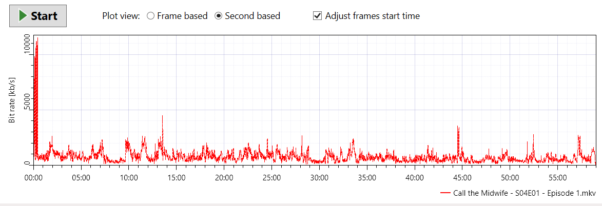

I’m usually working with H265 video. Do you know of a cheap/free tool that shows the same thing for HEVC? – Never mind. Found FFBiterateViewer.

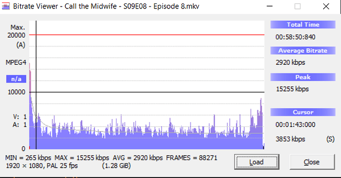

I did have another file in the series that was still H264 and came up with the image below (file size is 1.28GB and requiredBandwidths is pretty much 8095. I was guessing it was probably the intro as well on this series and that was confirmed:
