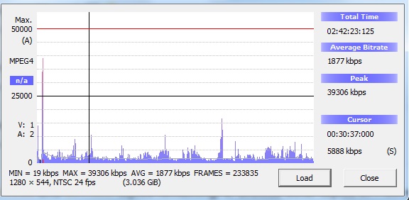

So i’ve checked the xml info and it does seem like its performed a deep analysis and according to bitrate viewer (great software btw) it concurs bitrate viewer
I guess the movies need to be encoded for constant bitrate as opposed to constant quality, especially for remote streaming.
But you can also see that if your player device had a network buffer of 75 MB size, this peak at the begining of the movie won’t matter that much anymore.
Those various numbers in requiredBandwidths are the required bitrates for 5/10/25/50/75/100/250/500MB network buffer sizes.

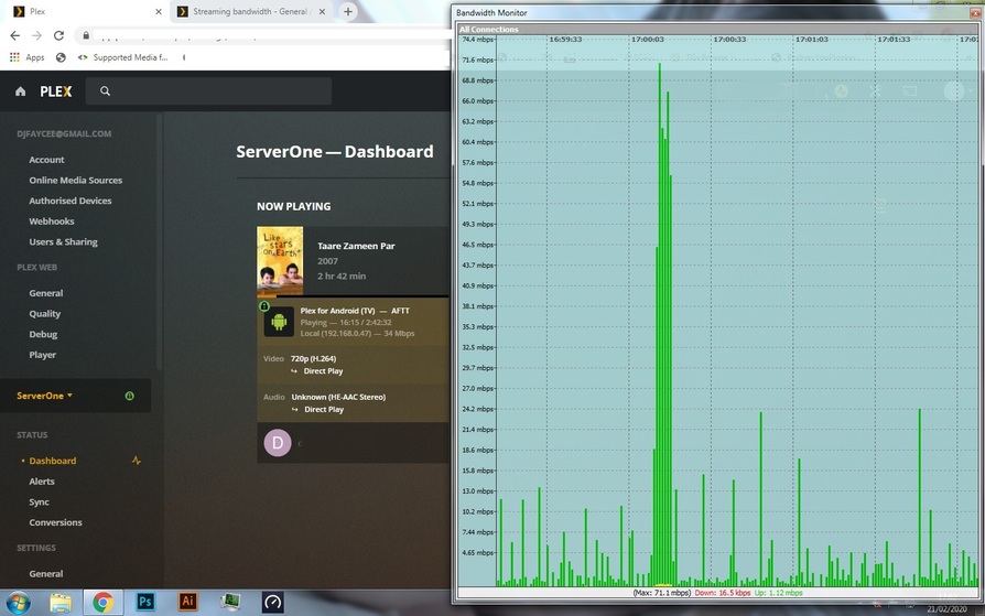

i’ll be honest, im not sure what you mean by network buffer size? when i do play the movie it stuttered around those peaks, the player device (firestick) i’ve just tested and its receiving 30-40mbps dl as an average
