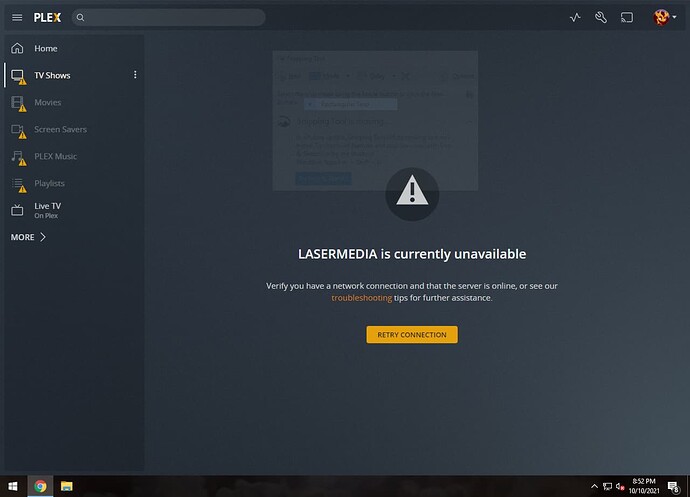

Thank you, I look into that, as for file locations and server name, it shouldn’t be a problem, all my drives should be mapped correctly and the server name is all the same, the install file is in my drive that was not the main drive, I got access to my app data and in the process of moving it now, once its in place then I can run the plex media server and see how it will see everything. I can post back how this method is working for me, at this time there is 35 minutes. Left now before all files are moved for the app data, I did make backups incase I need them but holy crap this is large data I am moving, app data plex media server is over 70gb XD
ok it looks like i got everything but i get this here, plex seen where i had everything after re installing it but its not working, i looked at the post and one of the things i may have to deal with is regedit, of is there a simpler way to get the server going

Go in Setting, Authorized Device e delete your pc/device.
After re-login.
For me it worked.
