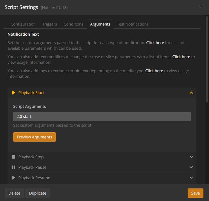

9 Go back to the browser tab that has tautulli in it and click on the “Arguments” tab. Click on “Playback Start” and enter the number of the device you want to stream to followed by a space and the word “start”.
then click on “Playback Stop” and enter the number of the device not hooked up to anything followed by a space and the word “stop”
  1. Click Save and exit the pop-up and you should be done.

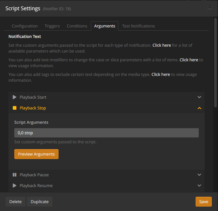

  1. in Tautulli edit the notification you made before and in the Arguments tab under playback stop type “stop” after the number you gave with a space.
  2. Save, close the window and you’re done
