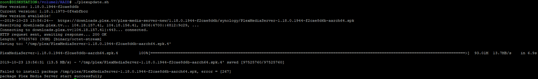

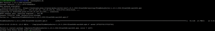

In any case, you are running into an issue with the synopkg install command. Can you check /var/log/messages to see if there are any clues in there as to why it failed?
The version it’s downloading and trying to install is 1.18.0.1944-xxxxxx which is older than the current installed version of 1.18.1.1973-xxxx.

@trent.curtis Change this line:
if [ "${NEW_VERSION}" != "${CURRENT_VERSION}" ] ; then
To this:
if [[ "${NEW_VERSION}" > "${CURRENT_VERSION}" ]]; then
