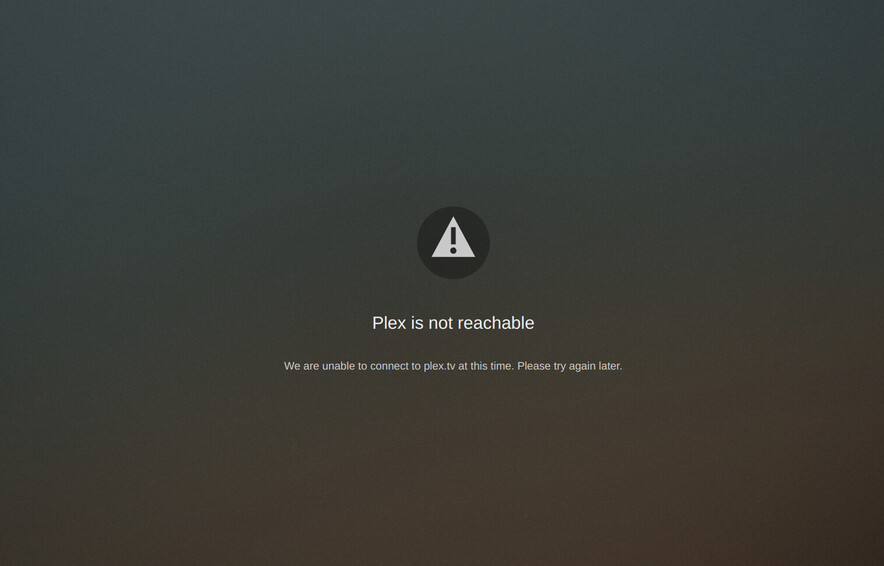

When I go to media.HOSTNAME.com I DO get to the plex server, but it says:
"Plex is not reachable
We are unable to connect to plex.tv at this time. Please try again later."
I have also set the Custom certificate location and Custom certificate encryption key sections of my Network settings (as well as Custom certificate domain) but I do not think that is necessary because the nginx is an ssl terminating proxy.
Any thoughts?
