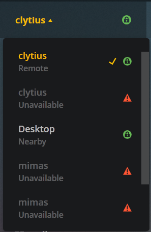

What I see when connected to my feral slot PMS instance
What I see at app.plex.tv
Mimas is another slot that feral setup for me to see if it would work properly with plex. They claim that they have many servers with no problems for plex users. I’m wondering if it’s older versions of plex that don’t have a problem.
