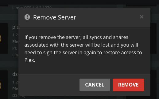

This confirms two active servers and 4 dead server entries.
The dead entries will throw Plex/web for a loop.
Please do go to https://app.plex.tv/destkop
From there → Settings - Authorized Devices (Left corner)
Now select the ‘Server’ dropdown where it shows ‘All’.
When you do, you’ll see something like mine.
For those dead server entries – Click the red X and “REMOVE” them.
When you’re done, you should only see the two active servers.
Now please go back to your server(s) and see what shows up.
Is this now less confusing?

I cleaned-up the account entries - removed the old (duplicated) devices.

Chuck,
This is STILL very much an issue - we’re back to Plex account dysfunction!
Now that every one of the servers (four of them) each with their own installation of PMS,
ALL HAVE UNIQUE “FRIENDLY NAMES”
ALL HAVE UNIQUE Machine Identifiers in Preferences.xml
They STILL are not connecting / staying connected to the Server installation where they reside.
If you check the accounting system it will show authorized devices for EACH of the four servers.
(Headless, Rootless, Tower, and Nameless, all by name)
AS WELL AS ENTRIES IDENTIFIED TO BE “Chrome” - adding another layer of ‘complexity’ and further emphasizing the Plex account dysfunction.
  1. I had deleted ALL references to “Chrome”, save for the one that shows “4.39.1” because I could not readily identify it or correlate it to the server machine that it is (was) associated with…
The others “3.95.2”, “4.30.2”, and “4.34.4” refer to the version of PlexWeb (of the PMS installations) that produced them and correlate to the machines Headless and Rootless (both with 3.95.2, that’s why there are two of them), Tower, and Nameless.
You will notice that despite having ‘nuked’ the “Chrome” authorized devices, they have been reproduced, IN LIEU OF USING THE EXISTING AUTHORIZED DEVICES BY NAME THAT WERE CREATED BY EACH OF THESE SYSTEMS…
And, that was AFTER each of these system was verified to be absolutely unique in their identifiers.
So, the first question which arises is, Why are the authorized device records produced by these systems NOT BEING UTILIZED subsequently? Which would serve to keep the proper PMS installations associated with the systems upon which they reside.
  1. I could tell that the named (by server name) authorized devices were not being utilized because when I would ‘nuke’ one of the “Chrome” authorized devices, the machine running PMS with which it was associated would tell me “Credentials expired please logon again.”
At which time, it would STILL NOT UTILIZE THE AUTHORIZED DEVICE RECORD IT HAD CREATED (previously), BUT WOULD PRODUCE A NEW “Chrome” RECORD.
  1. Each time one of the systems creates a new record instead of utilizing the existing authorized device record associated with it (by name that it had created), I have to RUN THROUGH A SETUP PROCEDURE (like what happened to Tower previously and corrupted it) AND RE-ESTABLISH ALL INCORPORATED LIBRARIES as to order and the way they are presented, i.e. GO TO THE LIBRARY TAB, instead of “Recommended” because it no longer “remembers”; the Plex account having produced a NEW authorized device record INSTEAD OF PROPERLY ASSOCIATING WITH EXISTING RECORDS.
This has now been done for multiple systems because of the consistent failure to properly associate with existing records.
  1. All of this further inspection of functioning was precipitated by the fact that one of the systems, “Headless” that had PMS running and still active, now appeared as “Nameless”, AND as I always had to do before when Plex “lost it”, restart the PMS container on the system to get it to reflect THE SYSTEM IN WHICH IT IS INSTALLED.
What gives with this continuing dysfunction?
Granted, being able to connect to another server might be a nice feature, BUT
  1. PMS installations SHOULD NOT BE “LOSING IT” by changing server references on its own whenever it feels like it.
  2. SHOULD UTILIZE EXISTING AUTHORIZED DEVICE RECORDS that the given device has already produced (unless someone specifically wants to create a new record and run through a new setup procedure by ‘nuking’ the existing associated record).
  3. A user SHOULD NOT BE FORCED to have to reorganize all of their libraries in a particular installation BECAUSE PLEX ACCOUNTING DECIDES TO PRODUCE A NEW RECORD (when a perfectly good record already exists).
