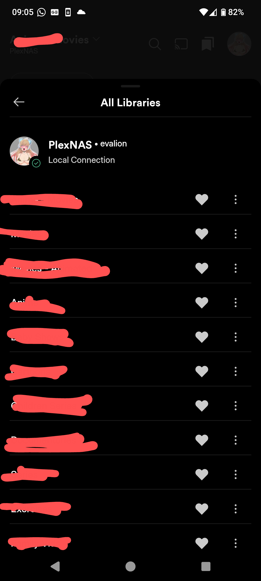

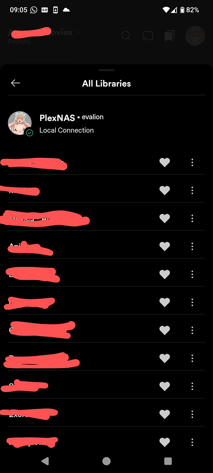

Please see screenshots, if anything looks out of place please let me know
