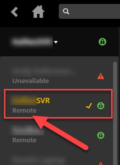

When using Plex via webpage, Chrome App , PHT, or OpenPHT on a device connected to my local network; my PMS (also on same network / subnet) is listed and I may connect, but it shows up as “Remote.” This happens even when connecting on the same machine PMS is installed upon! Details below screenshot…

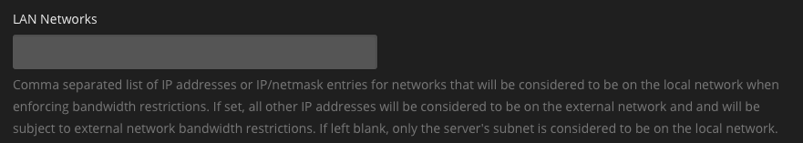

  • LAN Networks: Currently blank (Also tried 192.168.0.1/24, 192.168.0.1, 127.0.0.1, & subnets of my virtual adapters)

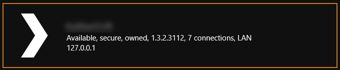

Just a random thought. don’t know if you have Plex player installed (don’t know how to do this in web) but click the ellipsis in lower right corner (three dots) and select server and see what IP is in there.
wondering with all those interfaces if its grabbing something you don’t expect.

@lqvnguyen this is the Windows 10 Plex app I did that from.

Thanks for Win10 Plex app suggestion. Had it installed, but don’t think I’ve ever used it. I launched it and it didn’t connect to or see the local server - just “Local Content” which wasn’t anything. In servers, I saw my server and it seems bound to 127.0.0.1. Obviously that’s the universal localhost IP, but why would it bind to it and how to change? It also shows LAN instead of WAN. How is that when the others show “Remote”? I’d think WAN and Remote would be determined using the same logic.

@mastoul I have one more suggestion for you. Go to Settings | Server | Network | LAN Networks and see if you have anything in that box.
No it’s empty
@mastoul said:
No it’s empty
Try putting in your LAN IP subnet.
Yesterday I have tried to put 127.0.0.1/24 but nothing changed. Now I should put my server’s LAN ip subnet like this 192.168.16.1/24?
127.0.0.1/24 would be incorrect. The loopback is a single IP subnet and is represented as 127.0.0.1/32. Whats important is to put in the LAN subnet as 192.168.16.0/24
