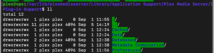

There is something very odd going on here for sure. When I cd into Plug-in Support for example I actually do see files. It is very strange that the system reports it as empty when I run the ll command at one directory level up.
For example please see these screenshots.
However this feels less like a plex issue and more like an OS issue so I might be barking up the wrong tree bothering you and the team here. I will do a bit more research on my own and see what I can find.
