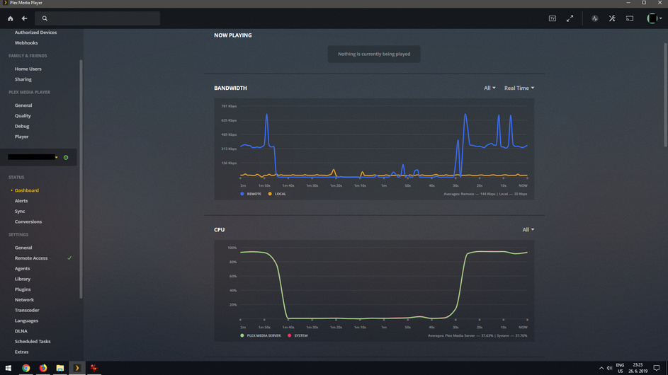

Stream bitrate original works maybe as intended. But why spiking to full bandwidth…
Stream bitrate limitation of 20Mbps doesn’t work. Still full bandwidth spikes.
Stream bitrate limitation of 12Mbps, 10Mbps and lower forces NAS to transcode, therefore plays nothing.
Stream bitrate original, but limiting bandwidth to only 20 plays video smoothly without spiking and transcoding. (setting I would like to achieve, but this way not applicable for more simultaneous users…we are limiting bandwidth…)

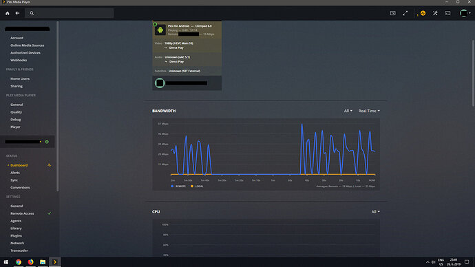

Full bandwidth, no stream limit:
Full bandwidth, 20,12,10 stream limits:
20 bandwidth, no stream limit:
Any suggestions please? Why stream bitrate limitation of 20Mbps doesn’t work? Now I need to run 2 separate servers on two separate devices, limiting bandwidth and making 2 simultaneous remote users each watching on its own server to fit them both into the 55Mbps uplink.

plex delivers streams in chunks not necessarily continuous streams, so you will see peaks and valleys where chunks are sent until buffer full, then pauses, then resumes again when the next chunks are needed.
the bw limits are average not exact caps
upload speed should equal your internet upload speed (or the total upload you want to dedicate to all plex streams)
limit remote stream limits the max (ave) speed of any particular connection
you should simply leave the remote stream bitrate at original, properly set your upload speed, and then plex will divide that total upload amongst all streams.
