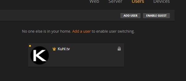

Ray Donavan was one. I’ll have to check on the guest account, I don’t recall enabling it. I havent given out my info to users, I make them use their own.
It would appear guest is not enabled, is there another way to check to see if its enabled?
