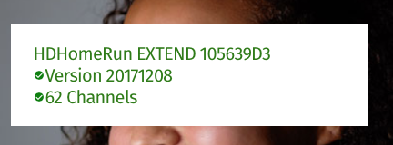

Well, that’s something anyway. You know it’s not a Plex playback issue. In addition to the networking stuff mentioned above, have you checked the HDHomeRun page to see if you’re current on Firmware?
http://my.hdhomerun.com
It should show your Prime, it’s current firmware (green check if up to date) and the channels available like this:
If there’s a red x by the firmware it means there is an update available.
