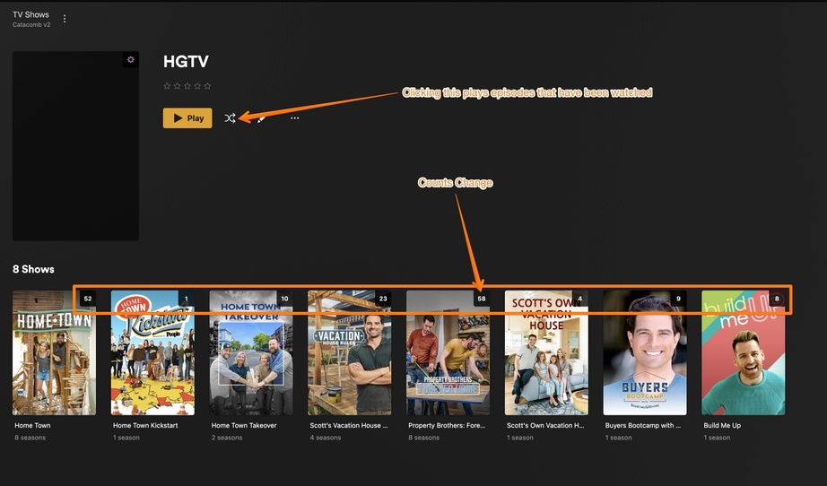

I setup a Smart Playlist for a TV Collection with a Filter of ‘Episode Unplayed is true’ (per suggestions from moderator here) so that the Playlist only shows Unplayed episodes.
I am getting episodes I watched already almost DAILY coming up when I click on Shuffle to randomly pick an episode for me. It’s like the Smart Playlist isn’t updating watch status after we watch something through it.

Sorry for the delay, busy week. Definitely (See screenshot below).
I rebuilt the Playlist from scratch on Thursday and this weekend EVERY time we tried a Random viewing it started with an episode that we have seen already!

When I go to the Collections, the Play counts are going down on each show after watching, but from the same page as the screenshot when I click Shuffle we get episodes that have been played more often than not.
I keep the server up to date (With Plex Pass updates) and have recreated the Playlist twice now with the problem persisting. It’s like it’s ignoring that one filter because it listens to the other filters (eliminating a few shows that are not good to watch in random order).
The numbers on the posters are not play counts. They are the numbers of “unplayed” episodes within.
Whatever they are, they are changing regularly despite continuing to get episodes that have been watched in full.

When I create a Smart Playlist it shows up under Collections. I don’t make a Collection and I don’t do anything extra.
Under TV Shows my Smart Playlist shows under Collections. I did not do anything to put it here, it shows here after I create it.
Going to the Smart Playlist I see all the shows contained and the counts for episodes that are unplayed. Those numbers change regularly when watching.
When I click SHUFFLE it plays episodes that have been Watched already
Despite my Filters are set to not include them. IF episode is UNPLAYED (TRUE) then include in Smart Playlist, therefore, when I click SHUFFLE in that Playlist, it should only play episodes that have not been Played (Watched), but that’s not what it is doing!

You created a collection of shows. The filters tell Plex which shows you want to be part of the collection, not which episodes.
Clicking shuffle plays random episodes from the list of shows in the collection. There is no filtering applied here.
This is expected behaviour.
Create a smart playlist or an episode collection instead.
If you look at previous screenshots, it absolutely has a filter for EPISODES that should filter out Unplayed episodes.

Requested screenshot. Only the Admin user is used via AppleTV
Basically just do what swift panda says - you have indeed created a smart collection of shows not a smart playlist of episodes
In this screenshot next to advanced filters change it from “TV Shows” to “Episodes” then save as smart playlist (and if you always play it shuffled you can even change from “By Title” to “Randomly” then you don’t even need to shuffle play as it will always be random)
The second dropdown above the filters says “TV Shows”. You are filtering for entire shows with unplayed episodes. You are not filtering for individual episodes. Change the drop down to “Episodes” to filter for individual episodses.
Your show “Home Town” matches the filter because it has episodes which are unplayed. By filtering for shows, you are telling Plex to add the entire show to the collection.
Ughhhh. I had no idea those were part of the filters /facepalm. I only used the ones under the ‘match’ drop-down.
