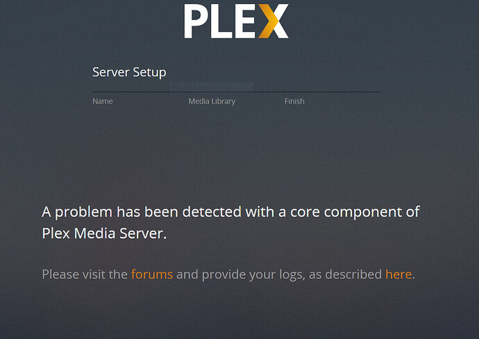

So I recently updated my freenas box to 1.15.2.793_1 and i now cant get to the server setup page

I previously had a working PMS on FreeNas but (don’t ask me why) I was tinkering and now I have done a complete fresh install of FreeNas 11.2-U3, only restoring my pool so as to retain the data. After installing the plexpass plugin and setting the jail mount points, sorting out all my shares and permissions, I select Manage from the plugin menu and get to the Server Setup page but get the error message " A problem has been detected with a core component of Plex Media Server."

 I was getting the same error “A problem has been detected with a core component of Plex Media Server.”
I just ran the following commands from a shell window:
> cd /usr/local/share/plexmediaserver-plexpass/lib
> mv * ..
Restarted the jail
This resolved the issue and I was able to continue with the Plex setup.

Also, before I saw your comments I attempted the fix using mv however my ‘lib’ folder doesnt exist at all.
root@plexmediaserver_1:/usr/local/share/plexmediaserver # cd lib
lib: No such file or directory.
root@plexmediaserver_1:/usr/local/share/plexmediaserver # cd ..
root@plexmediaserver_1:/usr/local/share # cd plexmediaserver-plexpass
plexmediaserver-plexpass: No such file or directory.

I showed in the screenshot that I also tried that and it does not exist.
