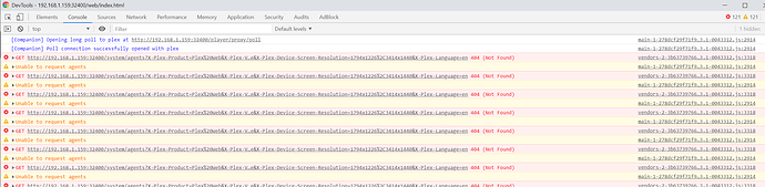

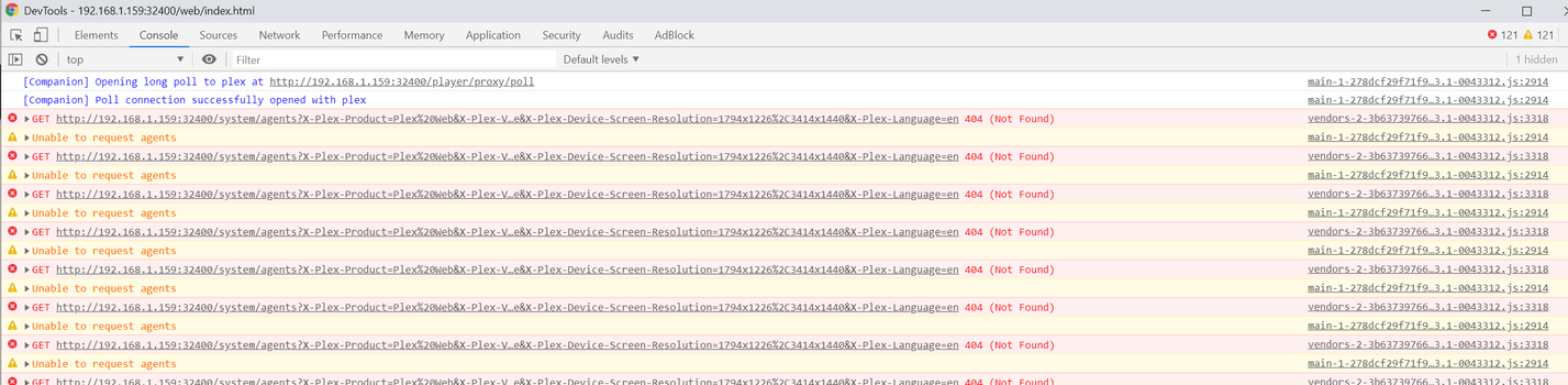

I debugged a little bit. My error is caused by this call is 404
http://192.168.1.159:32400/system/agents?X-Plex-Product=Plex%20Web&X-Plex-Version=3.83.1&X-Plex-Client-Identifier=2y996cb2k9a4y0vtjx7ux962&X-Plex-Platform=Chrome&X-Plex-Platform-Version=73.0&X-Plex-Sync-Version=2&X-Plex-Device=Windows&X-Plex-Device-Name=Chrome&X-Plex-Device-Screen-Resolution=1794x1226%2C3414x1440&X-Plex-Language=en
